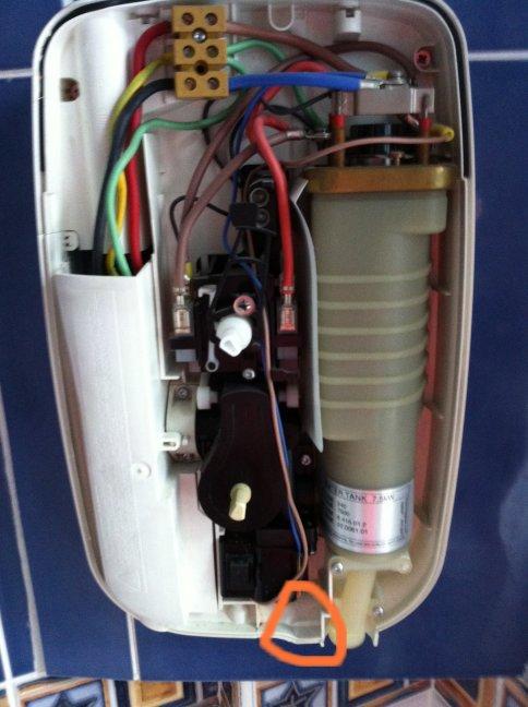

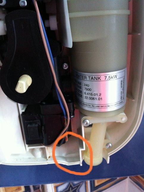

Hi, we have a Mira Sport shower unit which is approx 10 years old. We don't use it that much (it's in the 2nd bathroom) but I noticed a few days ago it was dripping from the bottom of the unit. Having a quick google around there are suggestions of scale buildup possibly on the inlet valve(?) - would this be easy-ish to fix for someone who's not massively DIY-savvy? It's not the end of the world if it can't be fixed but is there any way to stop the dripping? I've attached a couple of pics showing the area circled where the water drips into and then out of the bottom. Thanks in advance for any advice.

Have a closer look at where it leaking from. Make sure the power is turn off before having a closer look. It may be from failed weld on flow valve or from the top of flow valve near micro switch.

Thanks Dan. Sorry to appear dumb but could you advise where abouts the flow valve is, maybe on the pic? Thanks again.
Looks like the seal has failed between heat can and flow valve.
The flow valve is the black part.
Look where the silver sticker is you'll see the heat can join the flow valve, it has a o ring to seal the two.
Can you see scale around the join ?

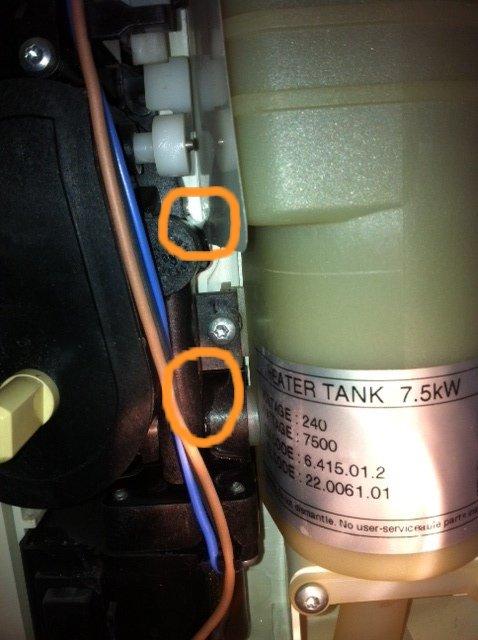

OK I've had a further look tonight and attached a new pic with my findings. I think the join between the heat can and flow valve is ok, I certainly can't see any sign of scale around it. However you will see on the new pic that the leak comes over the flow part of this area (lower circled). Following the leak upwards I have circled the highest point at which I can see any water, it sort of sits on the edge of the circular bit sticking out from the flow valve (sorry for the technical terms!) and next to what is like a flexible piece of card. I can't see how it gets to this point though, or whether this is the source.
Any more suggestions gratefully received. At least I have managed to shut off the electricity supply to it from the fusebox so it won't blow if the leak gets any worse.
Thanks again.
It's poss it's coming out of where the white lever arm is that activates the micro switch or just behind that where the flow has a join in it.
Or poss from higher up around top of heat can where the metel rim joins the plastic part of heat can.
I would say it's the joint on the flow valve.
Thanks - if it were to be that, is it reasonably fixable - if I give a plumber a call would they be able to sort it out fairly easily in your opinion? Thanks again.
A new flow valve is about £35 depending on age.
It is fixable.
But as for a plumber who can, some won't touch electric showers, some haven't got a clue, some know them inside out and will do a good job.
