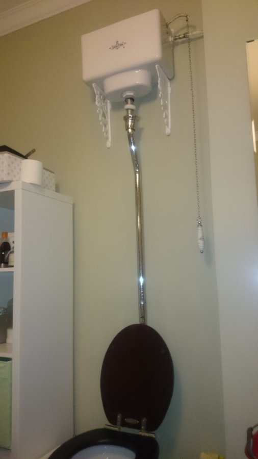

The toilet cistern is an old style Sanitan toilet

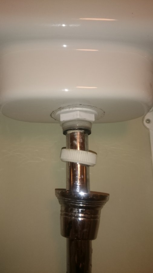

The problem is that it has always had a slow leak coming from the cistern. It wasn't a bad leak, but it meant the pipe was always damp and there was a small pool of water on the bathroom floor - which has warped the wood.
I fixed the original leak by putting some plumbers putty on the inside of the cistern. It was really my only choice as I couldn't get parts.
The problem is that now it doesn't leak from the cistern, but it leaks from the pipe - but only when it is flushed!
I have inserted the rubber ring and tightened as much as I can but it still leaks when flushed. Why would that be? What can I try next?

Syphon tail looks a bit short to me. Does the round nut meet the hexagonal, preventing the rubber washer being fully compressed? Also, viewed from the side are the syphon and flush pipe in accurate
alignment?
New washers, careful alignment and tightening should see you right.
Lovely looking cistern, bet you get a decent flush!

Many thanks. The comment from PolesApart solved it. The round nut was stopping against the hexagonal so wasn't compressing the washer.
I sorted it by removing a little sealant inside, so the tail was slightly longer and now the round nut tightens all the way. Drip fixed and all works perfectly. What a relief.
