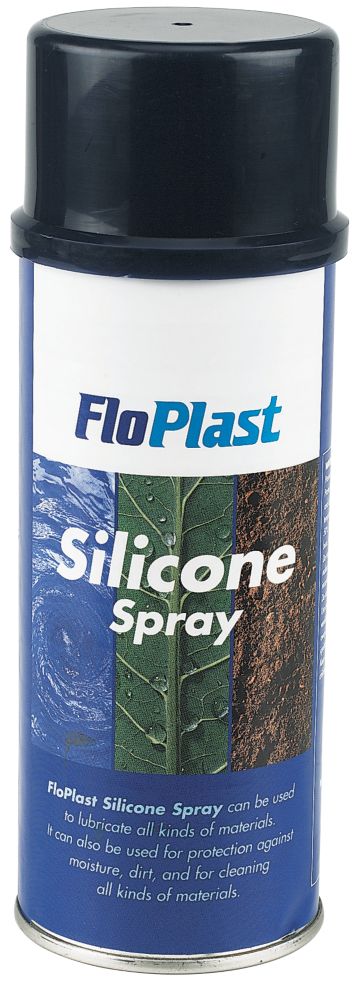

in desperation I used washing up liquid to get the pipe into the soil pipe, but nothing on the pan itself. What should be used?

I didn't think to use lube on the pan to connector joint because it went on easily - perhaps alarm bells should have sounded then! I'll get a new one and try again. The pan is only 4 years old, I assumed they are all a standard size. Do they come in different sizes?
