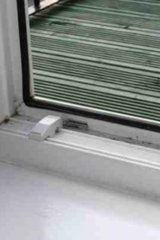

So it seems the door has been fitted the correct way round but unfortunately they put the opener on the wrong side!!?? This means the drainage holes are where they should be, if you open the door you should be able to see the drainage slots in the bottom channel, pour some water into that channel, the water should then come out onto the sill outside. If it doesn't the water is missing the sill and running down through into below.

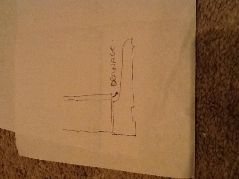

This is approx where the drainage hole will be, a slot like this

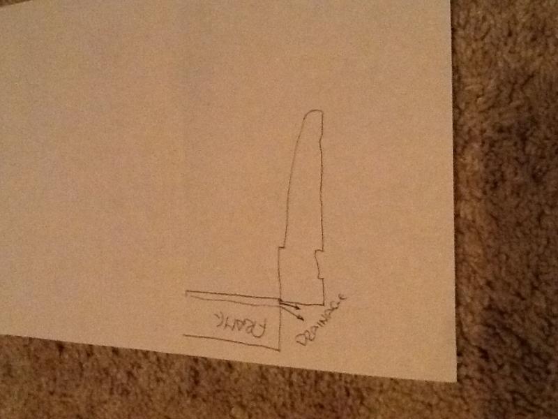

This is how the frame should be sat on the sill (it is not)
This is where the water should drain out on to the sill, bad sketch I know!
This is how I think your frame is sat on the sill and how I think the water is draining
can you now see the sill needs to go back so the whole of the frame is sitting on the sill??
The reason there's no gap along the sill is because is due to the sill being tight up against the frame.
The frame is fitted correctly in terms of its the right way round, the outside of the frame is on the outside, We weren't sure whether the frame was fitted the right way to start but now you say it's a tilt n turn the opening door can only go on one side (the inside), the fact that they've put the door on the wrong side is a mistake and doesn't affect the the way the door works, especially the drainage.

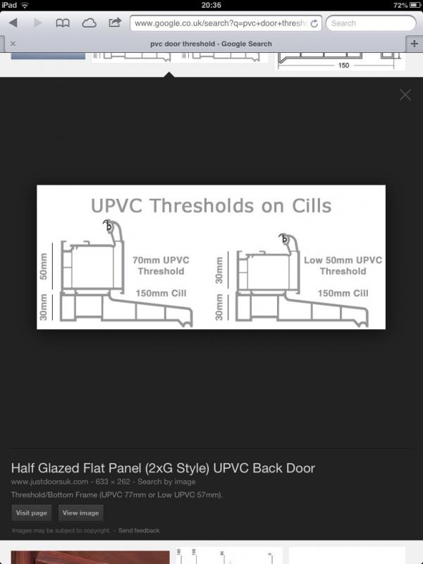

The big difference between the real doors and your diagrams is that there is a gap above the sill with an overhang in your diagrams but in the real doors there is no overhang or gap. If any water gets into the frame it has nowhere to go and finds its way down into the flat below.
This is driving me mad. How could they design or fit such a dreadful system?
