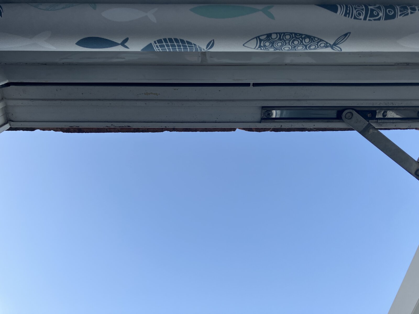

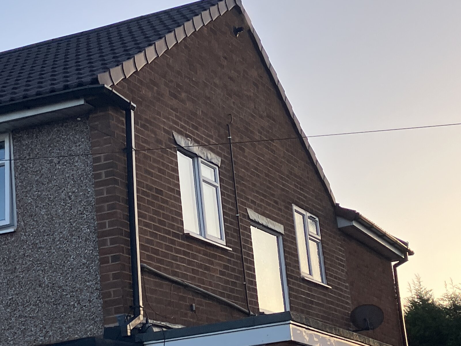

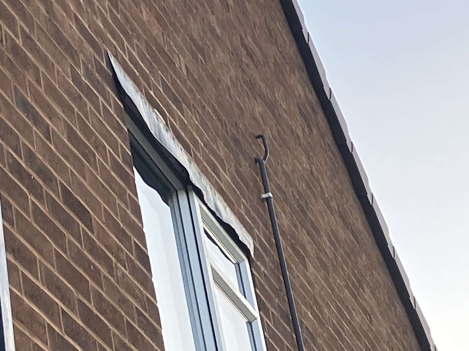

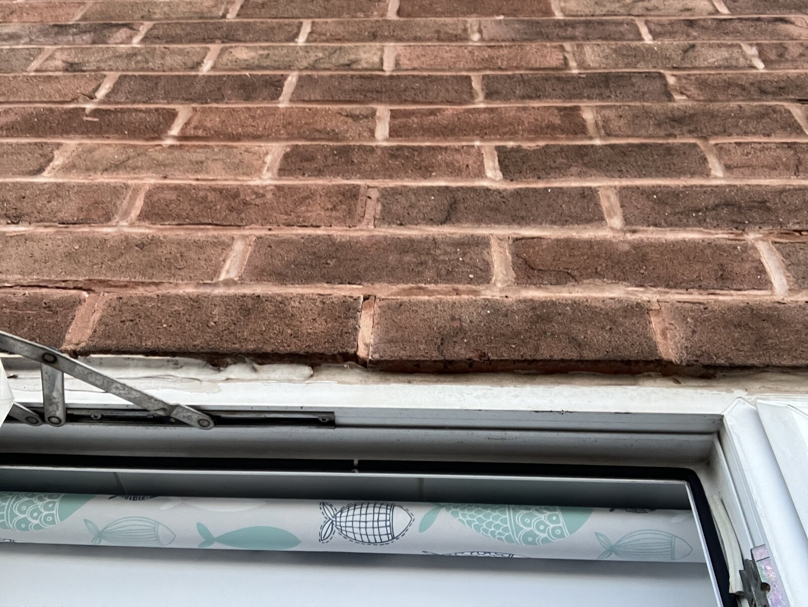

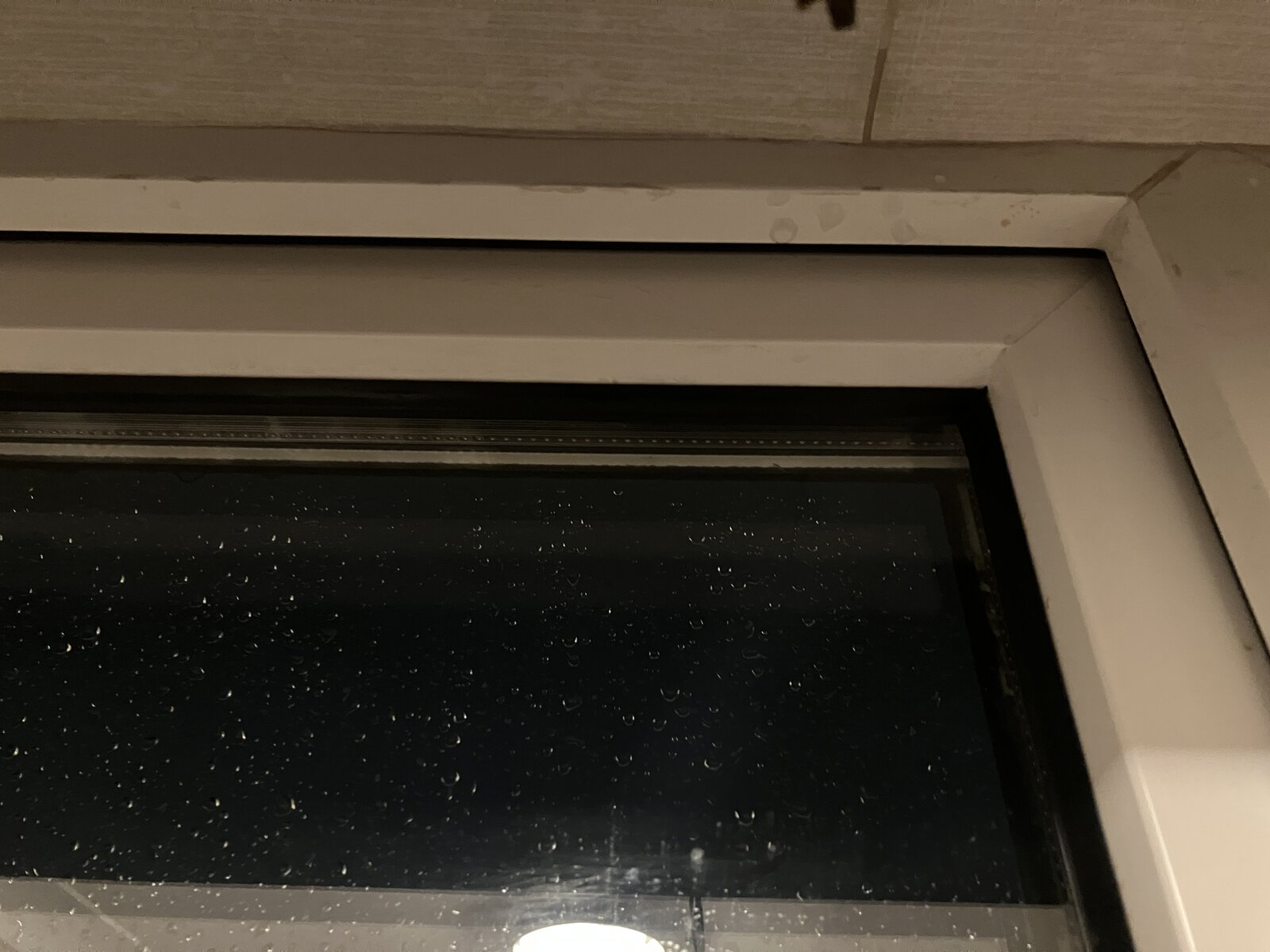

Here are some photos. The leaks are coming in internally exactly where the wallpaper/tiles meet the window.
Externally two windows have lead flashing directly above. The middle one was already there so was put in over 10 years ago. We put the one to the left in when we first had ingress thinking that might do the trick.
Brickwork gets absolutely saturated when it rains but is pretty dry this morning.

Your internal finishes bridge the cavity and are attached to the outer brickwork.
In laymans terms have the windows been installed incorrectly then? What is the solution new windows, remove them altogether?

Had a builder over earlier. He wasn’t sure of the existence of lintels but couldn’t be certain one way or other. His suggestion is installing cavity trays and then obviously assessing and installing/replacing lintels which seems like a good idea.
Most likely cavity condensation running down the cavity and sitting on whatever lintel is above the windows. There don't appear to be any weep holes? So the dampness has nowhere to go and will penetrate internally. Your builder's 'cavity trays' suggestion is reasonable but is a pig of a job. Do a search for Cavity Trays Yeovil. They make several retrofit products that will make the job a bit easier - they are an excellent company and always willing to offer advice.

Hi All. We had our work completed on all three windows. Lintels and cavity trays installed with weep holes. First driving rain since work was done 5-6 weeks ago, two seem fine now but one is still leaking rainwater internally above the window. The window and the frame itself shows no obvious damage so I am at loss. Surely any rain now getting through the external brickwork would drop down to the cavity tray and it should be impossible for it to find a route through except out through the weep holes?
I can only think that the rain is driving in between the top of the window and the DPC where there is a half inch or so of sealant which the bricklayer put in.
The guy is coming back to look and is a really well regarded bricky, his pictures of the work seems sound. Just wondered if there are any thoughts? It is such as head scratcher..
