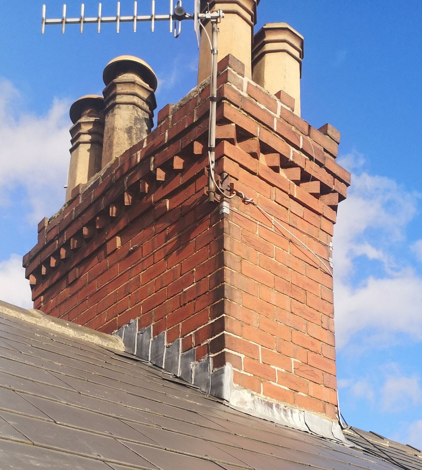

During heavy rain water is entering our roof around the chimney. It's a 1911 mid-terrace. We are calling roofers but I thought it might be worth posting some pictures here so we go in armed with a little information, or at least ideas. I would be really grateful if anyone could cast their eye over these pictures and let us know if anything seems obviously wrong (apart from the water :LOL:).

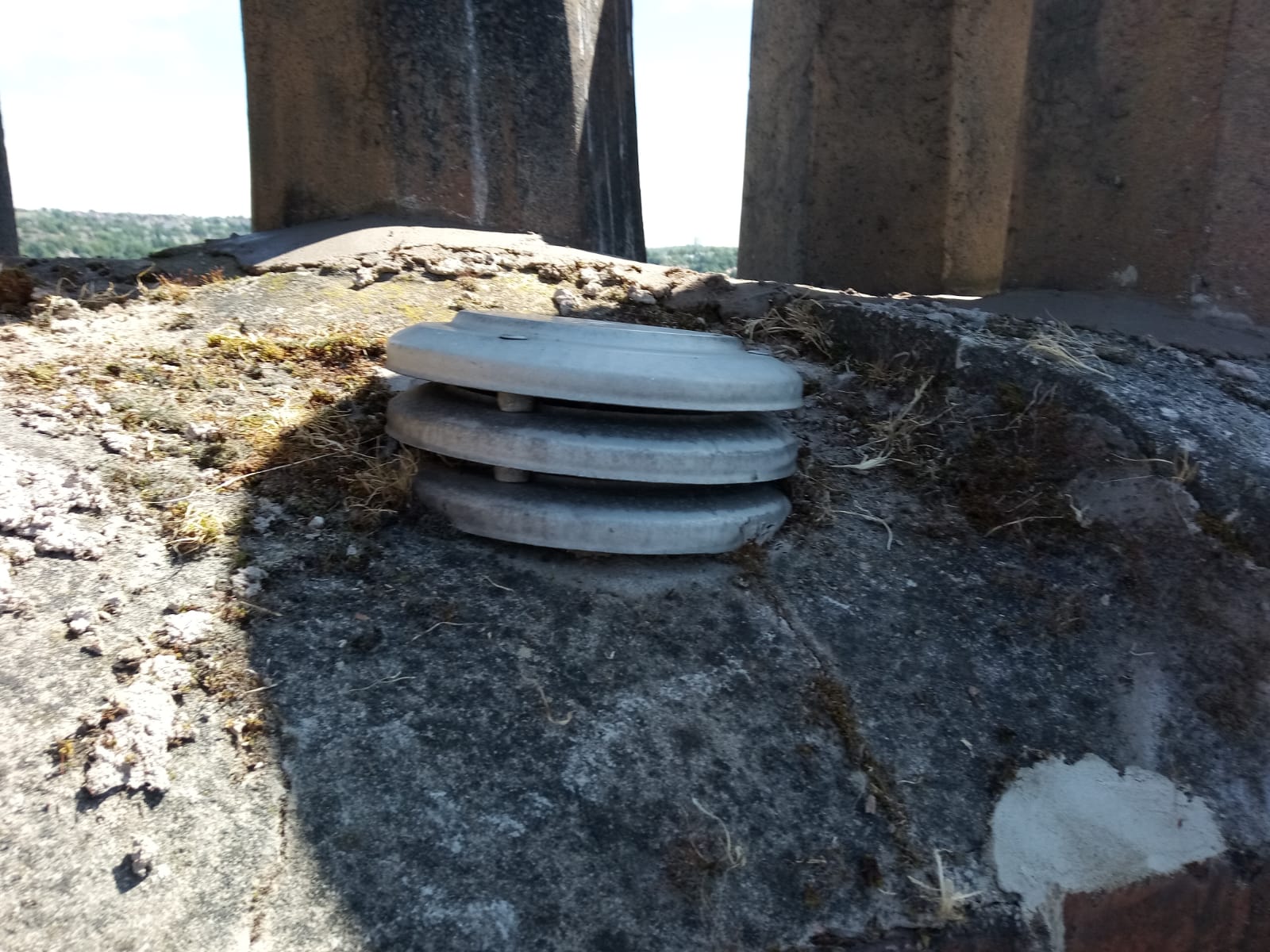

My eye is drawn to the tiles around the edge of the chimney sticking up a bit, and that really low gas cowel. But of course, I have no idea what I'm talking about! Any observations at all from people who do know would be very much appreciated (y)

Chimney head has been historically "pointed" here and there, at the top level there is a fair bit of mortar missing? on the short side nearest the camera.
not really sure of what is going on with the top of the stack, have some bricks fallen off, especially on the far end [from the camera??]
The lead around the stack needs attention, the wrap around on the right hand side appears loose? for starters.
Soakers are in place, but there does not appear to be anything else, meaning a small valley lead gutter, might be there but not easy to spot.
As for the gas flue terminal?? where to start? the vent appears to be iinside a depression in the flaunching on the top of the stack? indications of loads of moss Etc. around the flue terminal?
Cannot understand the vertical "things" on the same image?

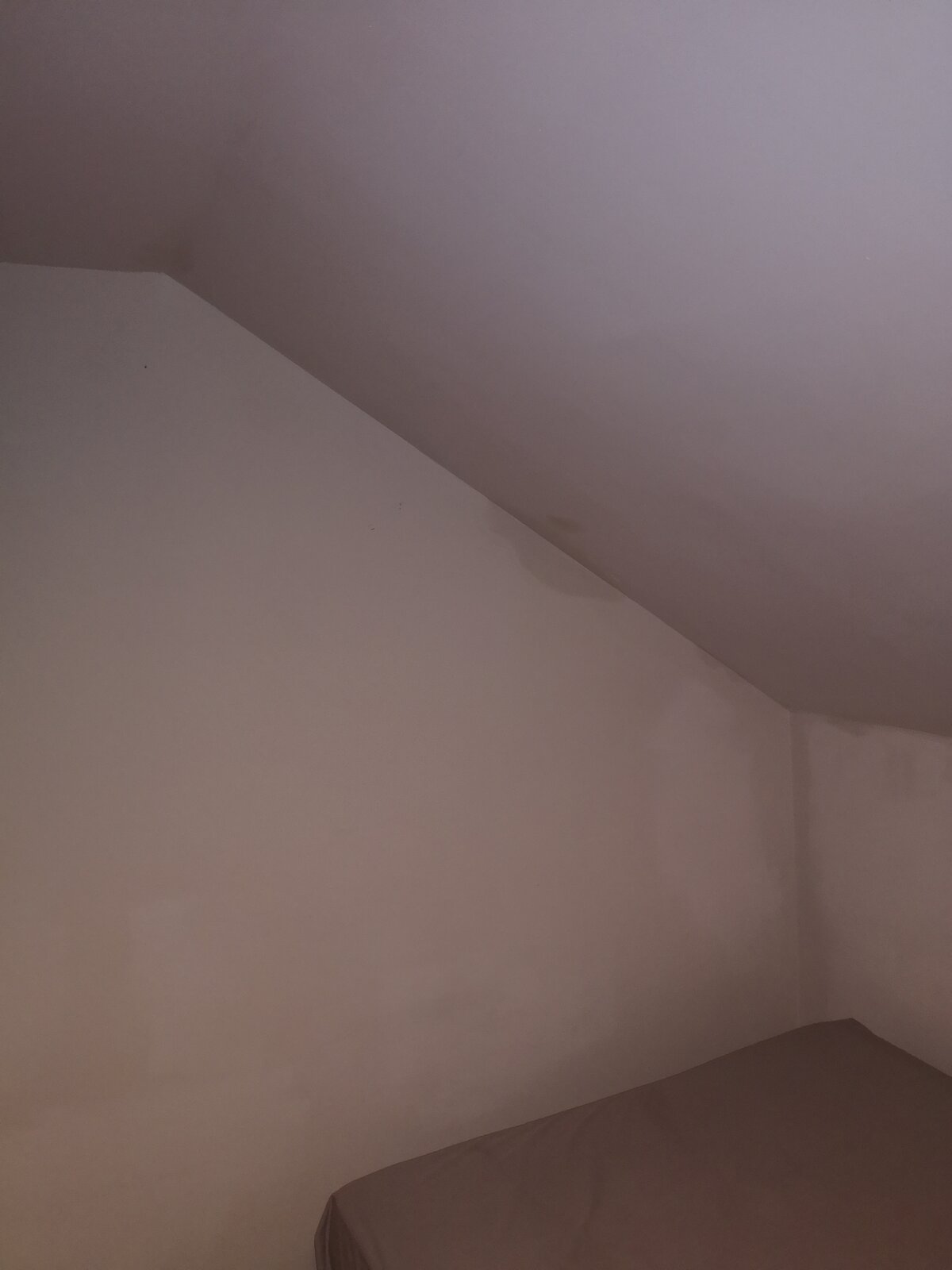

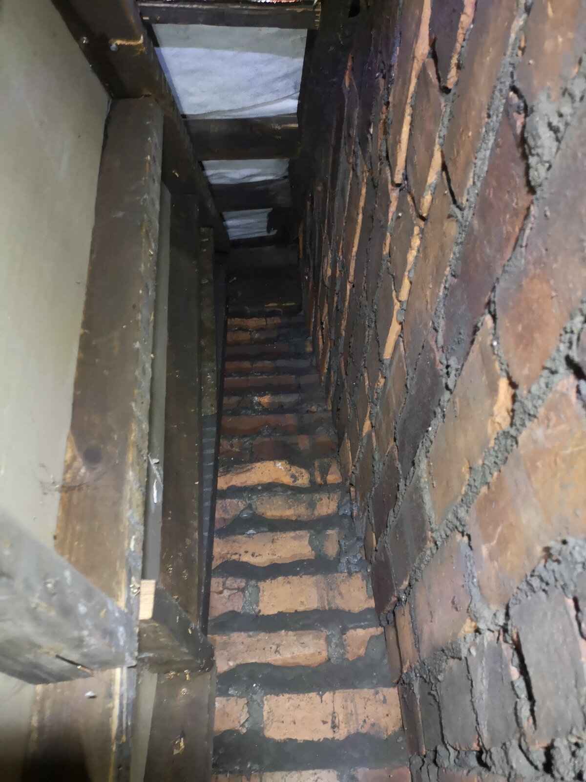

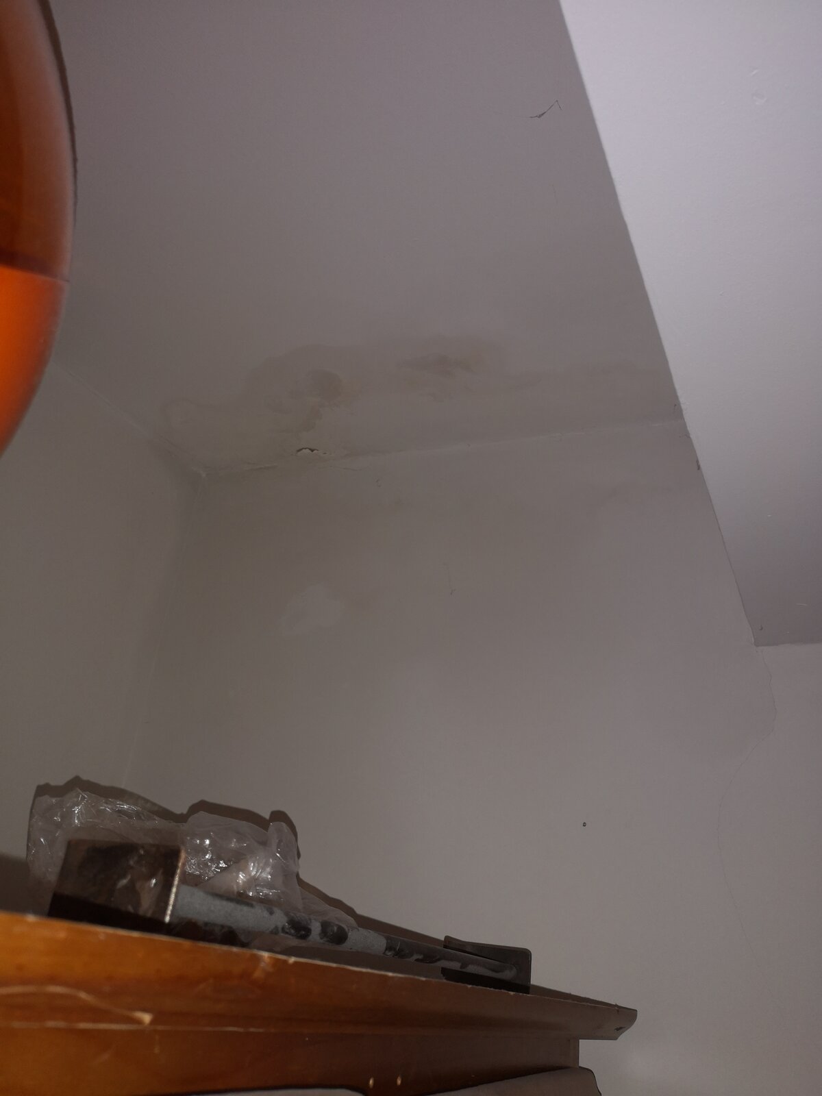

The exact point of the ingress is difficult to determine. The loft has been converted and I cannot access the top part of the roofspace. I am thinking about removing some plasterboard to get a proper look. From what I can see, water is getting in either around the chimney, through the chimney structure, or through the tiles around the chimney. It's not possible to narrow it down further without making a hole in the ceiling of the loft conversion where the first damp patch is. That bit of ceiling is flush with the left hand side of the chimney stack as the camera faces in my external photo above. But there are further patches developing down studwork atop a wall which is not actually directly touching the chimney. So it's travelling, or there is another leak.
I should have said that the right hand side of the chimney is our neighbour's so I'm not able to do anything about that. I can see that leading is a mess. I was really interested if mine was wrong! Sounds like it might be, but inconclusive. The state of the top of the chimney is as you say terrible. I think I will get the pots and gas flue removed (none of it is used) and re-flaunch my side no matter what I do. Seems sensible to get the leading re-done too. But what I don't want is to get all that done and still have a leak!
