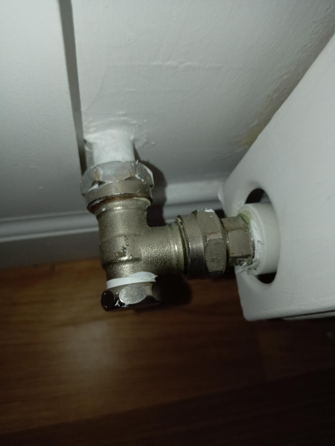

These are weeping from the cap where the Allen screw is. I've tried a couple of wraps of plumber's tape but they still leak a bit. Can I use general purpose silicone on the threads or do I need a fancy Fernox/plumber's thread seal type compound? And/or any other ideas to stop the weep?
Many thanks
* Second image is a valve from a removed radiator. I had originally thought the Allen screw would come out fully and I'd find an o-ring on the shaft - but they don't come out! :(
