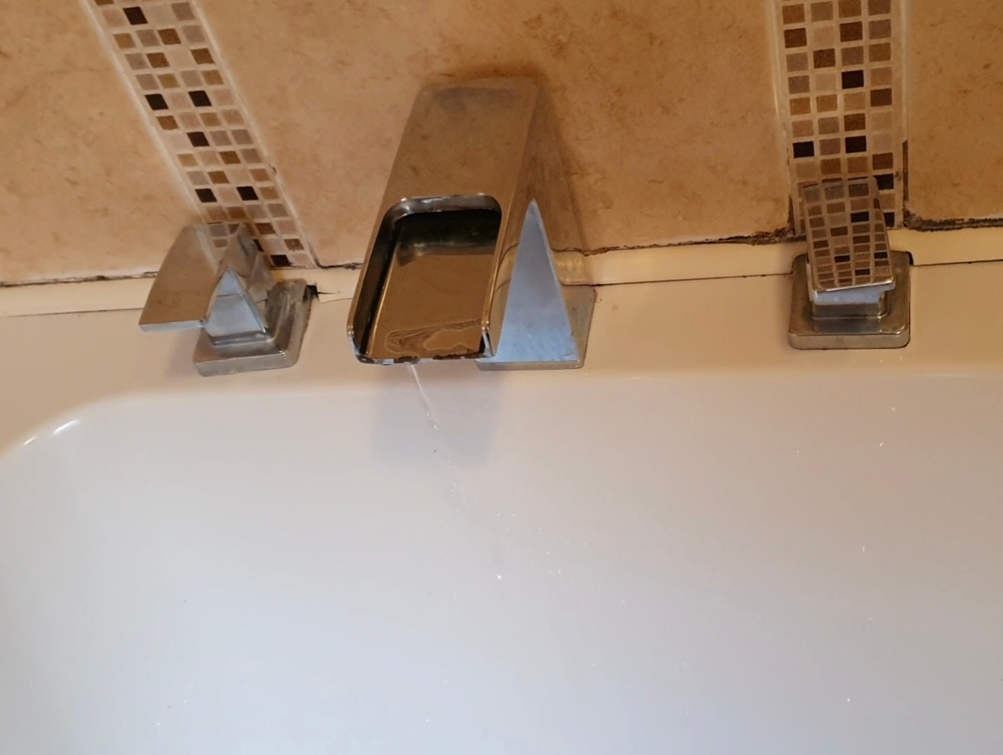

Hi
I have a leaky bath tap, normally I know how to fix but for this I see no screws, nothing that I can open and replace the cartridge. See image attached.
Any tips appreciated.
Thanks.

1. Three hole bath taps are, I'm afraid, the work of the devil.
2. You will probably find that the handles have long spindles which go down to cartridges below the level of the bath top. To get the cartridges out you may well have to remove the taps from the bath completely, which will require access to the underside of the bath.
3. For preparation, make sure you have a way of readily isolating the hot and cold supplies to the taps.
4. You may well find that there is a grub screw behind each tap handle, recessed into a hole. If so, isolate the water, turn each handle 90 degrees outward and remove the grub screw. They are usually 2 mm or 2.5 mm Allen head grub screws, so you will need appropriate Allen keys.
5. With the grub screws removed, or if there are no grub screws, the handles should pull off vertically. If stiff, pour very hot (but not boiling) water over the taps, which may expand them enough to come loose.
6. With the handles off you may see a hexagonal, usually brass, nut at the top of the tap works for each tap. Undo this if you can and that's the cartridge removed.
6. If all you can see is the spindle going downwards, you will have to remove the chrome base of each tap, then get underneath and remove the taps and then remove the cartridges.
7. As a suggestion, remove the handles, then post a further photograph of what can be seen.
8. If you know the make and model of the tap, look up the installation instructions which may give you a clearer view on how to change the cartridges.

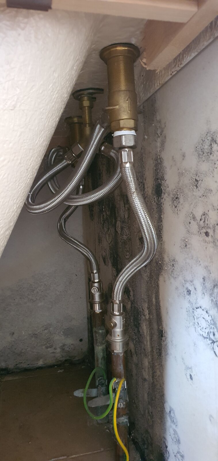

I managed to get the side panel off, this is what I see. Any advice as to what to get, what to do appreciated.

1. At least you have isolation valves fitted which should enable you to turn off the water. The chrome fittings just above the copper pipes. Turn the screwdriver slot in the centre. Slot at right angles across the valve = closed, parallel with the valve = open.
2. Then remove the handles, as above.
3. Post a further picture of what's underneath the handles.
4. With respect to access, seen much worse.

Will try, but I can see big difficulties in getting my arm down that space with an appropriate tool, then being able to fit the tool to the screw, then being in a position to be apply to apply enough force to remove the taps!!!! Will try - lets see! Thanks again.
1. The taps will most probably be fixed from the top. Quite how you should be able to see with the handles removed.
2. With the top fixings removed you may have enough room to withdraw the mechanisms from underneath without undoing the flexi hoses, at least sufficiently to undo and remove the valves.

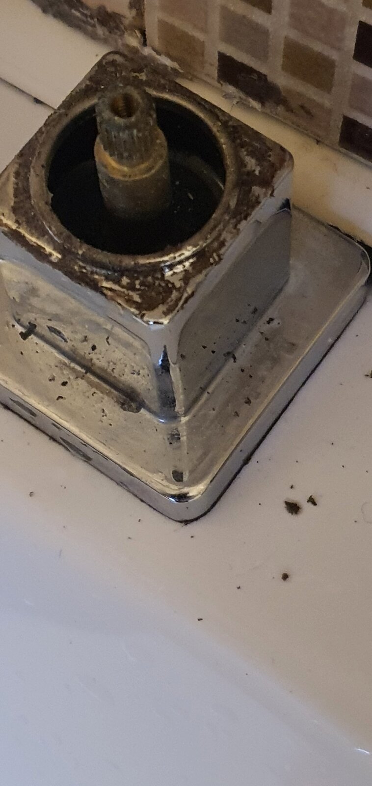

Manage to get the top of the tap off, this is what I see. Any advice as to what I need to buy would be really appreciated. Thanks.

1. I can't see properly inside the square chromed shroud.
2. If there is a hexagon nut inside and you can get to it with a box type spanner, it maybe that it unscrews from the top and the body of each tap comes out from the underside of the bath.
3. If no hexagon inside the square shroud, you would have to disconnect all the flexis from the brass bodies of the taps (not the central part) and unscrew them from below.
4. Its possible that the shrouds screw onto the tap, but were perhaps installed before the quadrant beading which looks as if it would prevent their rotation.
5. If you can illuminate the interior of the shrouds and provide another photograph their interior, it may be possible to be more precise.

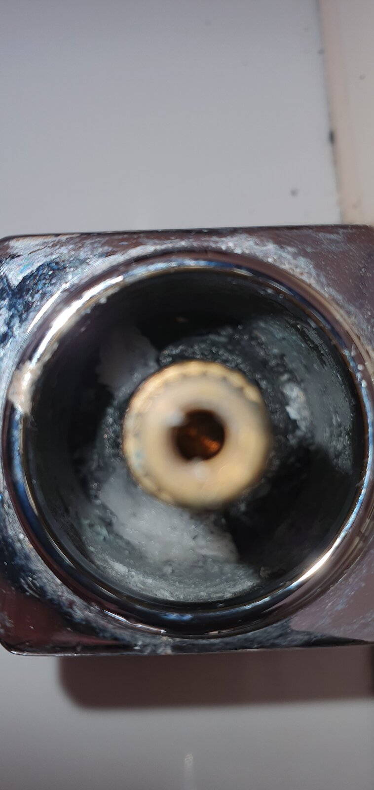

Completely not apparent from the attached pic, but there is a nut on the inside.

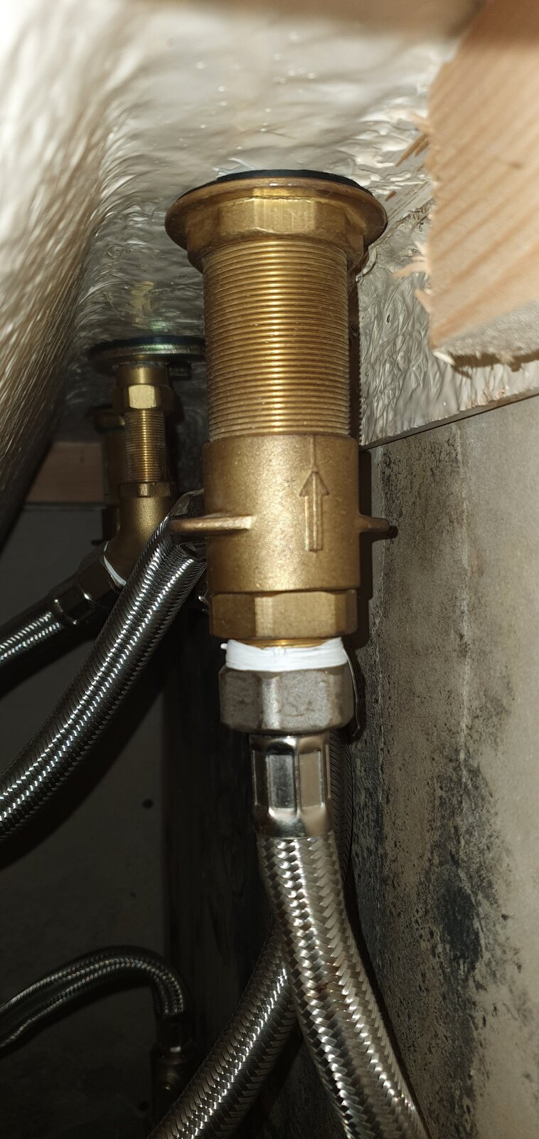

Continuing this saga, how do I open this ? It's under the bath and I cant get a good grip with any tool? Is there a special tool or something?
Thanks.
