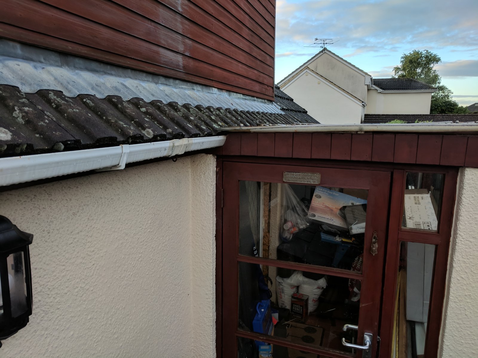

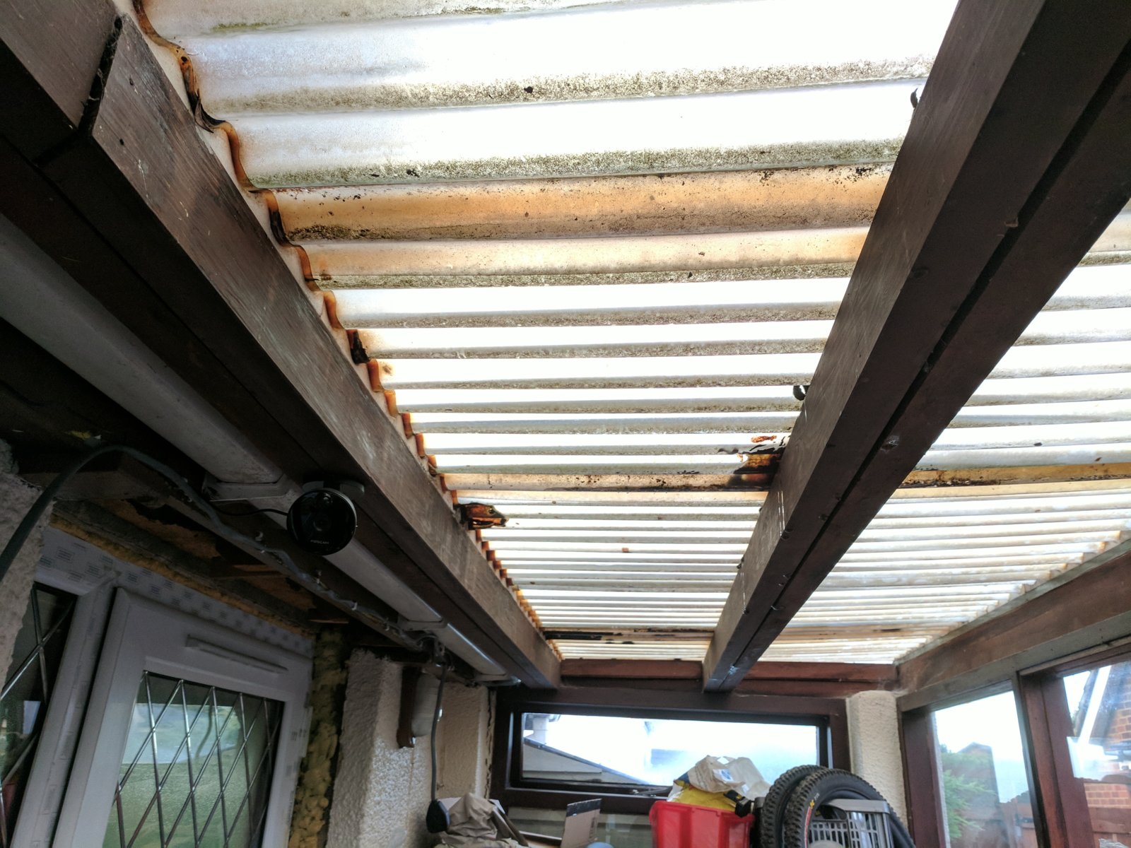

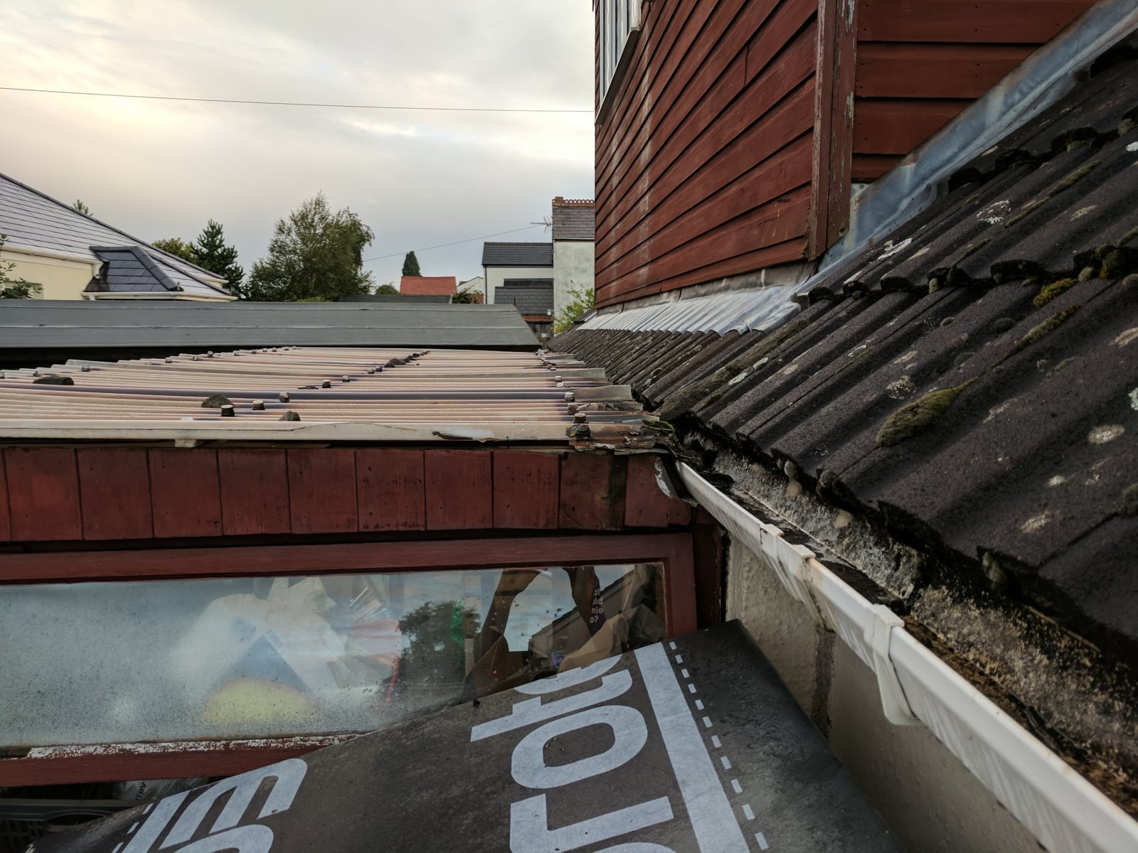

Hi,
I need to look at my rear porch roof before Winter set in, as the old corrugated roof is leaking like a sieve and is more fibreglass patches than PVC by the looks of it!
Attached are some pictures, I want to move the gutter, it is a continuous length going through the porch at the moment but I want to reverse the pitch of the roof and place the gutter around the outside.
Does anyone have any advice how best to tackle this? My initial thought was one of those self supporting polycarbonate systems, tucked under the existing tiles, with the guttering routed around the porch.
