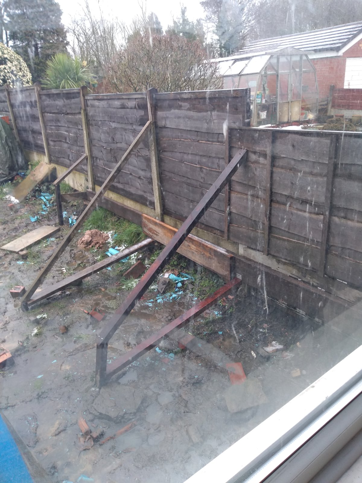

I've just drilled a few posts to prop up my boundary fence while I dig my extension foundations. The horizontal timbers and the diagonal struts are all screwed and plugged to the posts:
I didn't get any cracking (started off with a 5.5mm SDS bit) but did hit the steel when drilling away from the centre.
I would probably drill the holes before installing the posts (if it does crack you won't have to dig it out) and have a practice on a part that will be in the ground first to establish where the steel is.
