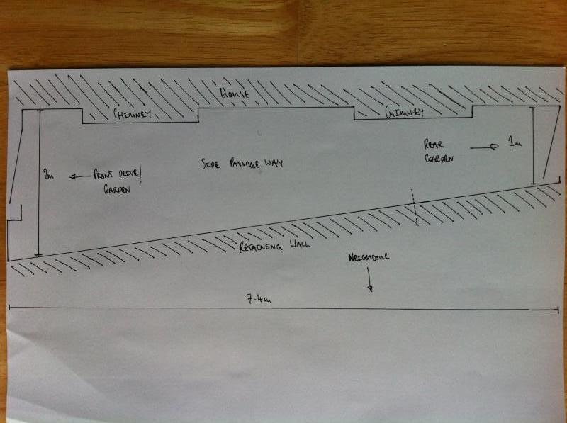

I'm planning on utilising the the side access down the side of my house (end of terrace) by building a lean-to for storing gardening equipment and my bike (limited space in the garden for a shed).
The space is bordered on opposite sides by a retaining wall (currently about shoulder height high) and the side of the house (with 2 protruding chimney breasts) which are not parallel. There are gates at either end. Something like this plan view:
Ideally I'd like the roof to be clear to provide as much light as possible.
Could anyone provide any advice on the most suitable structure of the frame and materials to use? I'd prefer glass to polycarbonate but am wary of the weight and am unsure how best to fix panes to timber trusses and to create the best seal against the house wall.

If you have your heart set on a glazed roof then you are best off using a proprietary glass roof system similar to that of polycarb, where the glazing bars are made of either plastic or aluminium.
I say this because a timber and glass roof will be a maintenance nightmare particularly down that side and would soon become problematic.
PVC window companies could supply only or supply and fit. Or research Glazed roof systems and DIY the lot.
Keep the gutter wholly on your property.
What may be a problem is the design. Either you stagger the roof sections or you fill the taper completely which would mean a twisted and tapered roof covering. Not sure whether this would work with glass but would defo' with polycarb.

I'm after a glazed roof as there is no opportunity to fit normal windows on any of the boundaries.
The main issue I'm facing is the level of detail required - given the non-parallel boundaries and that the chimney breasts aren't evenly spaced - so the design would need to be bespoke. I thought a timber frame would be most adaptable.
I've put in plenty of research time but am not clear about all the components that would be needed. Any suggestions on good websites that might set these out?
