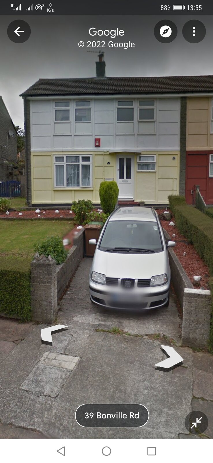

I'm about to build a covered lean to on the back of my house, approx 6m x 2.5m with twinwall polycarbonate cover. My house has been insulated with polystyrene and rendered over the top so I need to cut through to get to the verticle concrete lintel/post things....I'm wondering if it's actually safe to drill into the concrete or will they likely break apart when using 10mm concrete bolts. Iv attached a photo of my house befor it was insulated so you can see it's construction.
