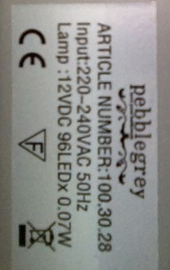

I have a similar mirror. I ran 3core&earth to the mirror and did a little rewiring so that:
  • The shaver point is premanently powered from the permanent live
  • The heated mirror is powered from the switched live so it always comes on when the lights are on
That means you aren't faced with a steamed up mirror when you step out of the shower and want to curl your eyelashes. You will often forget to turn the mirror heat switch on..
Even better, you also cannot forget to turn it off. Otherwise it could run for days..= ££ + melt another icecap
Seeeeee that is exactly what i wanted to do Taylor, but i was told that it wasnt "allowed" -
I just need to find a mirror/cabinet that i can do that with i guess, what one did you get might i ask?
Of course you can, if its done properly
This is the one I got
