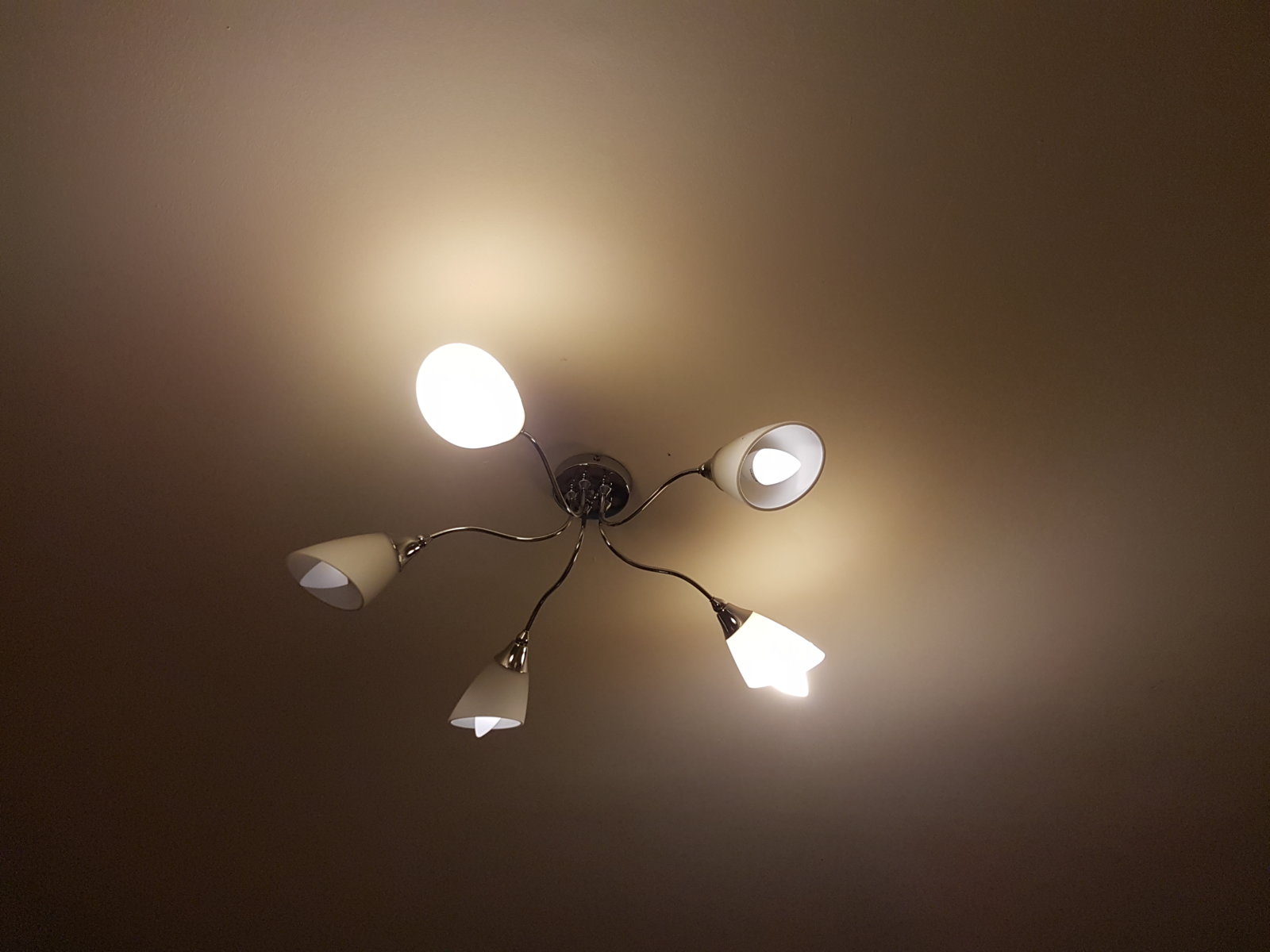

I have a five bulb light fitting in my living room. I previously had 5 energy saving style bulbs in it of which 3 died. I then replaced these over time with 3 LED bulbs which stopped working after about 6 months. I then put in another 3 LED bulbs and again they are now still working but the l8ght they are giving out is maybe about 80% dimmer than they were 6 months ago. The remaining 2 energy saving bulbs are still going strong.
I appreciate I am not buying the most expensive LED bulbs but I am wondering if I could be putting in the wrong type of bulb e.g. too powerful or too weak. The LED bulbs at the moment are E14 fitting 5.5W 470lm 47mA non dimmable. The energy saving bulbs are E14 7W 60mA.
I get that it could just be the bulbs are poor quality but regardless I would expect the LED ones to last longer than 6 months? That's 6 now.

Do these fittings have shades and what is the lamp orientation,Ie is the E14 lamp base at the bottom or the top when in the fitting, heat generated often causes premature failing.

Rocky might have a point. Heat may be your issue
The centre of the fitting has about 30cm long arms which extend out to the bulb fitting. Where the bulb screws in is covered by frosted glass although it is not totally encased and the bulb itself has about 5-7cm space around it's circumference. The energy saving bulbs are hot but I would expect that. The LED bulbs ate not hot to touch although if I unscrew one the metal screw fittimg on the bulb is hot to touch. The bulbs screw in at about a 30 degrees with the bulb pointing down the angle i.e. towards the floor.
Are you sure the bulbs are failing & it is not just a bad connection in the lamp holder. Have you tried removing & refitting?

The screw-in lamp holders do get weak over time. Sometimes it is necessary to use long nosed pliers (power off!) and pull up the centre contact a bit.
LED lamps run on low current, so any bad connection will stop them working.

I've tried the bulbs in the other holders but they do the same. The energy savers work regardless of where they go. Don't have any other E14 light fittings to check them with. I do have a similar light fitting in another room which has three BC fitting LED bulbs and they have been fine for over a year. Only difference is they point up.
Bit clueless at the minute. I don't wantbto just replace them for the same to happen again.
Is the answer to just go back to energy saving style bulbs?
