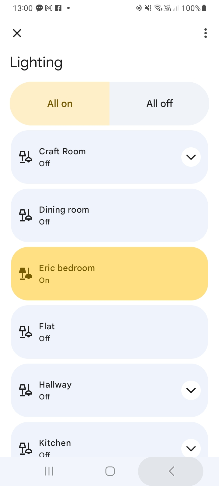

My problem and I will assume also yours, it to switch on the lights when required, and switch them off when not required, we tend to walk into a room and flick the light switch, and same walking out. So any lights supplied from another source very quickly end up not used, as we don't want to walk around the room switching them on.
So I have used smart devices, this means I can with easy turn them on and off, so they are actually used. There are a host of methods, from kinetic switches, to voice commands, in the main as long as the voice commands systems will work with the devices, they say "Google Assistant compatible" on the box then the google home app with work them. So you get something like this 1705928472153.png on your phone, so I in this case with one tap can turn on all on or off in a room, or hold and I get 1705928662077.png so I can select which lamps I want. I actually use voice control, but that needs the Nest mini's to work that.
If using smart devices then does not matter where the power comes from.
