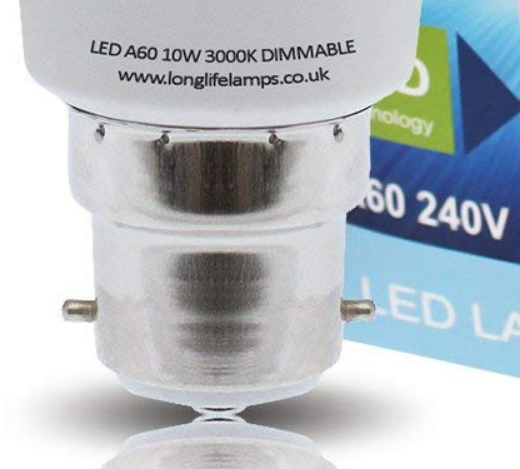

Long Life Lamp Company said:
3 pack GLS 10 W a60 LED light bulb with brightest of 100 W incandescent bulb replacement. High performance fourth generation LED inside with super bright light output, constructed to high quality with life, fitted with new chip technology SS518 chip reliability. Luminous flux is 800 lumen a60 shape B22 bayonet base, incandescent bulb directly. Length is 112 mm. No lead or mercury. 90 percent saving in running costs power consumption only 10W ideal for general purpose room lighting, not dimmable.
But there is actually writing stating dimmable on Martyn's bulb itself.
Obviously Amazon could send the wrong product, but easy for Martyn to check.

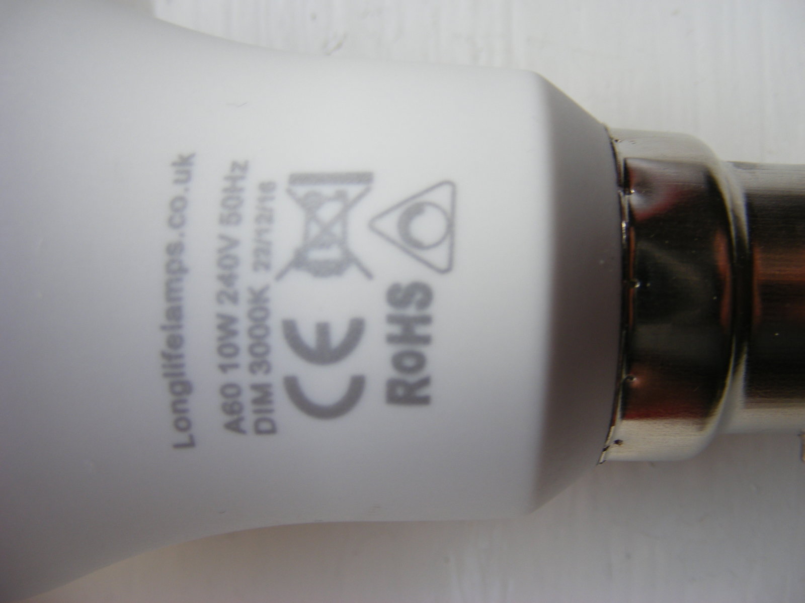

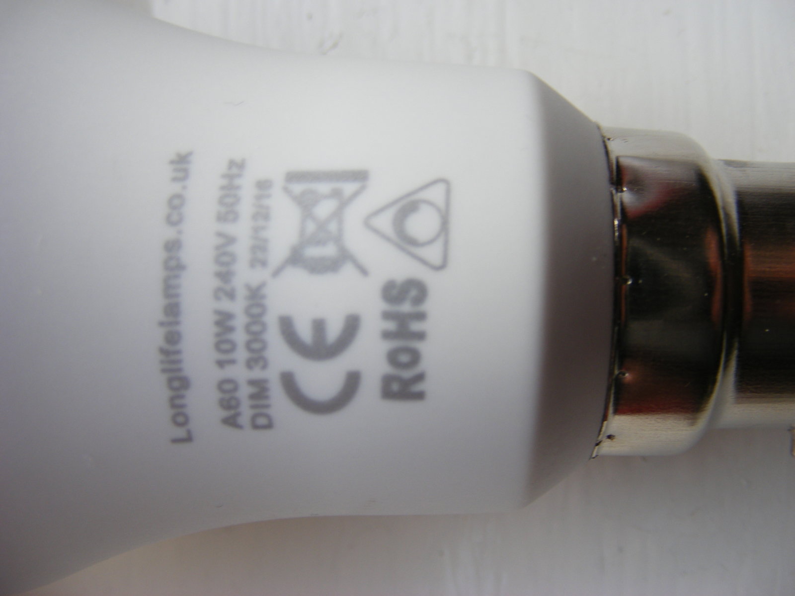

This is a picture of the LED I purchased from Amazon on 12/11/2017.
