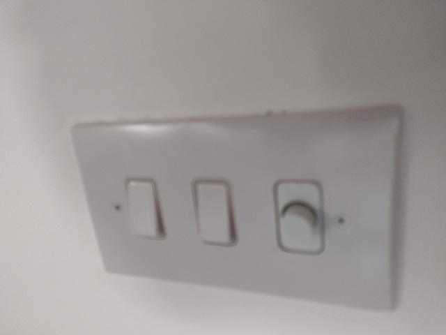

I've got some downlights that were fitted by a sparky in 2014 that are dimmable without a soft start This is what the dimmer looks like:
Any thoughts on this ?

The switch you show looks like a grid switch. Cheapest grid system seems to be LAP which I think is a screwfix special.
