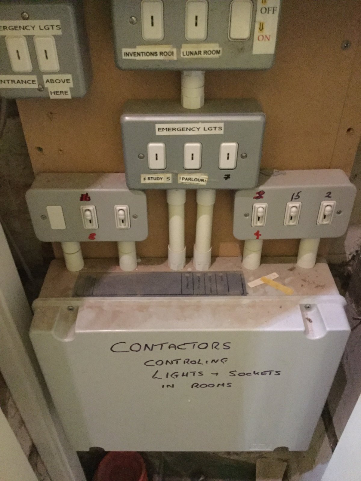

Hi folks, I recently replaced a number of downlights 240v 50w with leds. My problem is, I did not know that the original lamps were on dimmer switches(sliding) and the leds began flashing after a short time. I replaced one of the leds for an original spot and this has stabilised the leds. I was wondering if I could replace the dimmer bank with a joint block and effectively bypass the dimmers. Can anyone please advise
It seems that you replaced one of the LEDs with an "original" halogen lamp and this corrected the problem.
If you wish to keep the "dimmable" function operative, you should replace the existing dimmer with one that is suitable for controlling "dimmable" LEDs.
(Or, you could keep in circuit a suitable incandescent lamp or a small resistor which will bleed the pesky capacitive discharge from your existing dimmer.
Your choice!)

thanks ban-all-sheds, I should explain I live in a small museum. The control box for the lighting is in the hall downstairs, the room upstairs has lighting key switches. So if you should want to dim the lights,
you have to do so downstairs, not very satisfactory and I have not used the dimmers in five years. So wiring them out seems a good solution to me. I hope that I can then save money by using all leds.

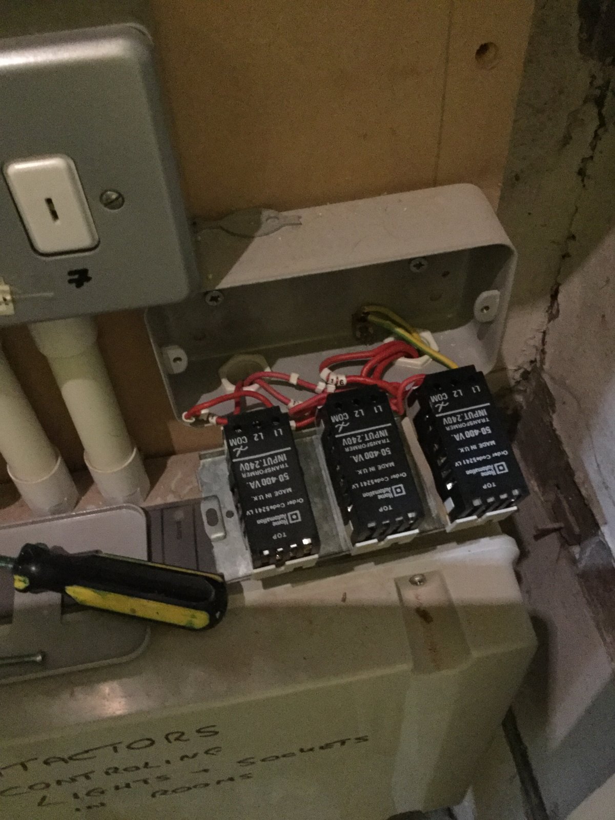

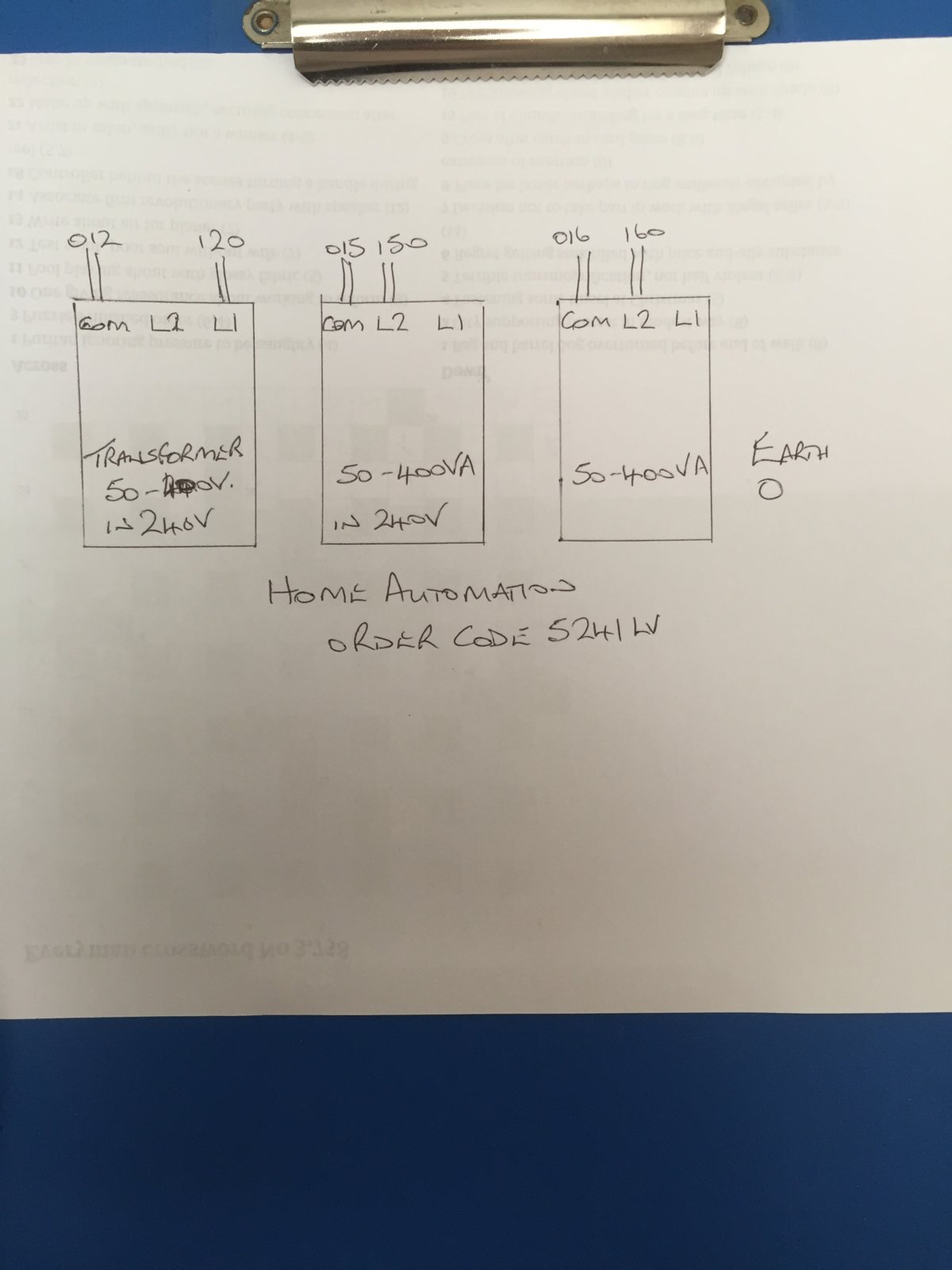

Post a photo of the wiring to the dimmer, some of us are helpful enough to give some helpful guidance.
Thanks ttc, here are the pics
Arghh not enough detail.
You need to disable one of the slide dimmers, yes?
Which of the dimmers are you talking about?
What cables connect to C, L1 and L2 on the specified dimmer?

I would like to disable/bypass all of them but could start with one as a test to see if it will stabilise the leds.
