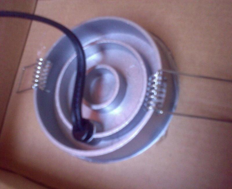

I have been refurbishing my house and want to install LED downlights at ground floor level. The rewiring is being done by a fully qualified electrician (part p) but I am supplying all the materials. My house is three storey, so no compartment floors and 30mins fire protection required. The LED downlights I have purchased (made by ELco) do not have replaceable lamps. They are solid aluminium (no holes and pretty substantial) castings and fit in a 70mm hole, retained by spring clips. There is no mention of them having any fire rating (though to look at them they would clearly be pretty good at holding back a fire) so I have bought fire hoods for all of them. The problem is that with such a small hole the hoods are proving impossible to fit (I have 100mm Rockwool in the floor void to aid sound insulation which isn't helping). It might be possible to fit hoods to some by ripping up T&G floorboards above and pulling out the insulation so I can work from above, but I suspect that the end result would be that the floor had less fire resistance than if I hadn't bothered! Both my electrician and I are wondering if its really necessary. I have read the Bill Allan article on 'installing recessed luminaires in ceilings' from the Wiki in this forum which has given me some cause for hope, as my LED downlighters have to be superior to the type of downlighters used in the 1996 TRADA tests.
Ceilings are 12.mm plasterboard and skim, joists 175mm with 100mm Rockwool between (previously 9.5mm p/b and artex). I also have linked mains fire alarms to every room (except the bathrooms) so have done a lot to upgrade the safety of my house compared to what it was . I have also just now written to the lighting manufacturer for their thoughts.
My electrician works on the 'precautionary principle' and needs just a little more before he is willing to sign it off without the hoods. Does anyone have any views or additional material that might help us decide what to do (hopefully not to put my LED lights on Ebay!) Many Thanks

Have heard back from the manufacturer that the lights aren't fire rated, but I guess that doesn't mean they wont provided some protection, just not 60 or 90 minutes. I have attached a picture showing the rear of it, I don't think it would compromise the ceiling too much, particularly taking into account the comments in Bill Allans article //www.diynot.com/wiki/electrics:lighting:downlights:firehoods. Any thoughts?
If a downlighter is fitted into a ceiling void where the only source of fresh air is from the room below, then yes it will take a long time for a fire to break through. But if fresh air from elsewhere can enter the void or this was the top floor ceiling, it would be a much more serious situation due to the fire feeding on and spreading towards the source of fresh air.
That would be my situation, no other ventilation to the floor void, and the lamps themselves seal their fixing holes.

This is my dilemma, additional protection may be required, but is it required in my case, or is my proposal fine as it stands. The test reports basically says that small openings for downlighters don't compromise the integrity of floors that are required to provide fire resistance of up to 30 minutes, so far so good. In my case the holes will be filled by lumps of cast aluminium, which must hold back the fire for 5 minutes at least before the fire gets into the floor void, then the rockwool which is fireproof will give further protection. Both of these elements weren't there in the TRADA tests and still that floor was found OK. To me this says that 'additional protection' should not be required in my case.
If I can't use my downlighters as they are, then for about half I will have to install fire rated downlights that take GU10 LED lamps (I'm trying to save the planet!) For the remainder I could rip up the floor boards and insulation to fit the fire hoods, or just use more fire rated downlights and more LED GU10's. To replace all the lights I have bought with Fire rated downlights and GU10s will cost me another £700 on top of what have already spent for my current lights so not something that I want to do if its not necessary.
