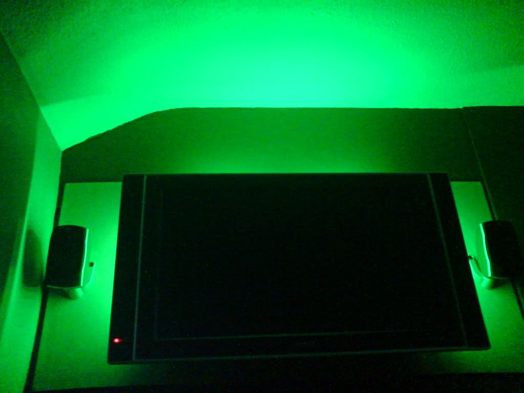

Oh, and in reply to In Your Face, check this out:
http://i239.photobucket.com/albums/ff284/Crafty1289/DSC01095.jpg
http://i239.photobucket.com/albums/ff284/Crafty1289/DSC01096.jpg
http://i239.photobucket.com/albums/ff284/Crafty1289/DSC01097.jpg
http://i239.photobucket.com/albums/ff284/Crafty1289/DSC01092.jpg
I have colour changing ones behind my LCD screen, which is a Philips, so I call it my home-made Ambilite. :LOL:
I also have white ones on top of my wardrobes, shining on the ceiling.
The units consist of foot-long strips of PCB with LEDs at inch intervals. The strips come in packs of four, and can be linked together in a strip of star-fashion. The colour changing ones come with a controller that will either sequence through every colour imaginable or stick to one colour, or white. And the white is RGB white, so it is a better version of white when those "cold blue" LEDs you see.
The plain white strips aren't too bad colour-wise either - the technology is delevoping.
