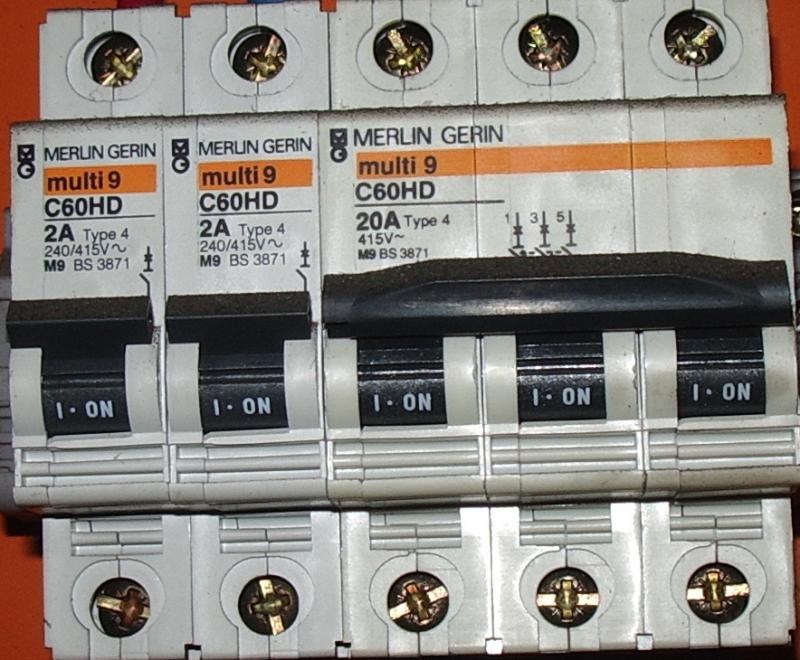

The 6A MCB is the lowest rated MCB available, since you will add a fspur of 3A there is further protection along the circuit.

However, I'm with you on your assumptions as to the wattage of each fitting. Standard individual 3 or 5mm LEDs really do not consume a lot of power.
MEM, GE, Hager, Merlin and Contactum all make them. They're available in B, C, D, 6kA, 10kA. You will probably have to order them as they're not normally on the shelf.
