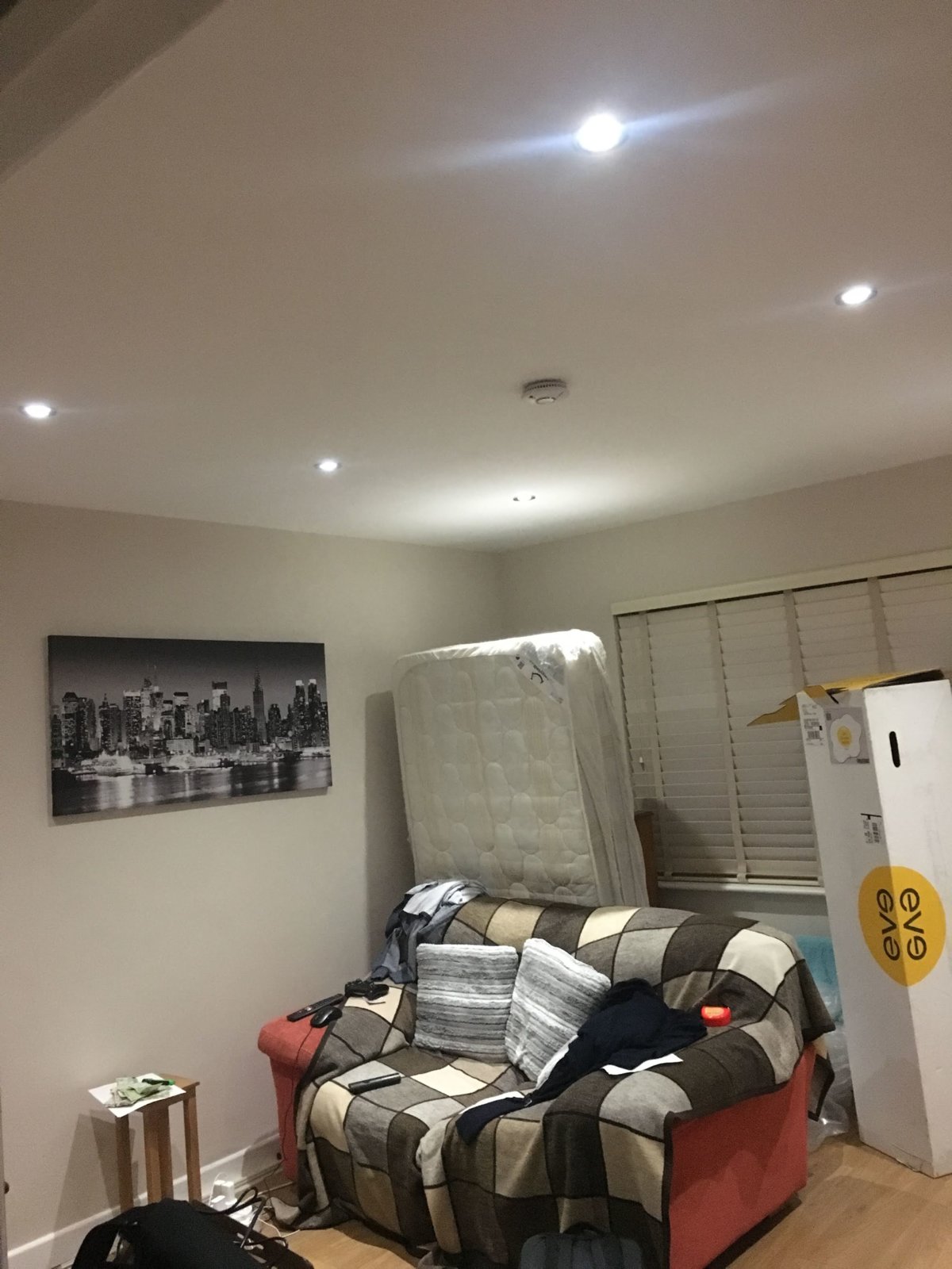

I can live without fancy Wifi lights, I might just get these as direct a replacement https://www.downlights.co.uk/aurora-enlite-e5-led-downlight.html
they have the 3000 warm white ones. I currently have 6 of them in my lounge. I wonder if even they would be too much.. photo of my lounge attached..
my lounge is about 10 foot m2 ..it's also a bit untidy !
