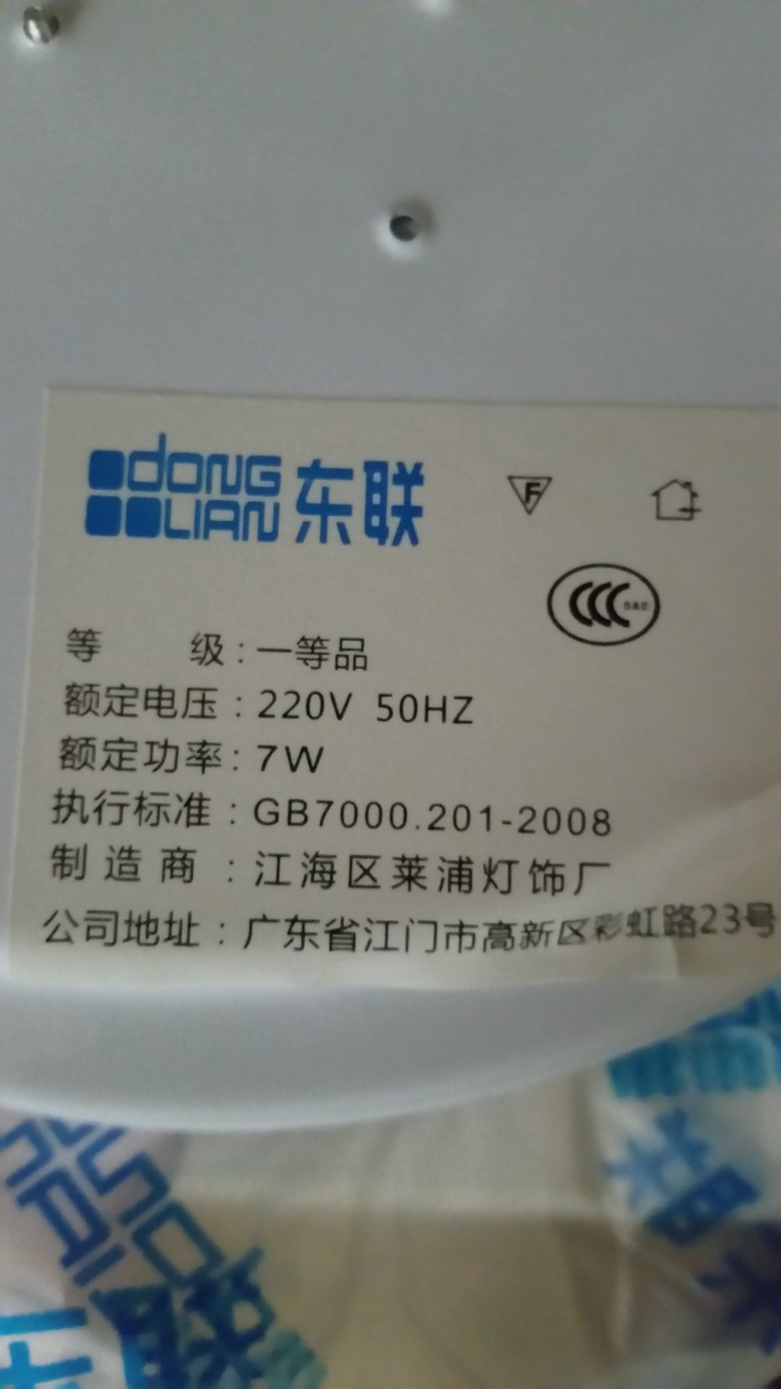

I have some LED light fixtures that were bought from China. They are generally all metal with a plastic shroud to cover up the guts of the fitting. Inside they have an LED transformer.
I've wired a few up and they work perfectly, but the issue is that they have no attachment for the ground wire. With these types of fittings, there's no bulb to replace so no one should be touching it unless the thing breaks. I'd still like to make sure it's properly wired up though.
Some images below of the fitting:
Appreciate any suggestions on what to do - other light fixtures I've put in the house have been from IKEA and they had grounding screws attached to the body of the fitting already, but they were also traditional bulb based fittings.
I would fit an earthing tag to the case for when that driver module self destructs.

If I can firmly attach the ground wire to the casing then that should do the job, I suppose am earth tag or screw would work in that case.
If the LED transformer breaks and I have to replace the whole thing, so be it.

I appreciate the candid replies, I realize there are a lot of dodgy knock-offs. Dong Lian is a fairly well respected brand in China however, and it complies to their national standards. Whilst not as rigorous as our own, they are still considered "safe". Some of the ones I have do have a proper ground so I don't see any issues with these. For the non-ground ones I may just replace those. Apart from the grounding issue, the LED driver could potentially fail but it is fused so that would just mean throwing it out in that case.

I can't see by your photos if these units a Class II double insulated and do not require a earth (shown by a square inside a square), or if they are Class I devices what do require an earth (shown by a earth symbol). Also, the CE mark on the power supply is a Chinese Export mark and NOT the CE mark of European Conformity. See here for more details on the difference.
Also, the tiny distance between the incoming live wire and the PCB worry's me! :cautious:
