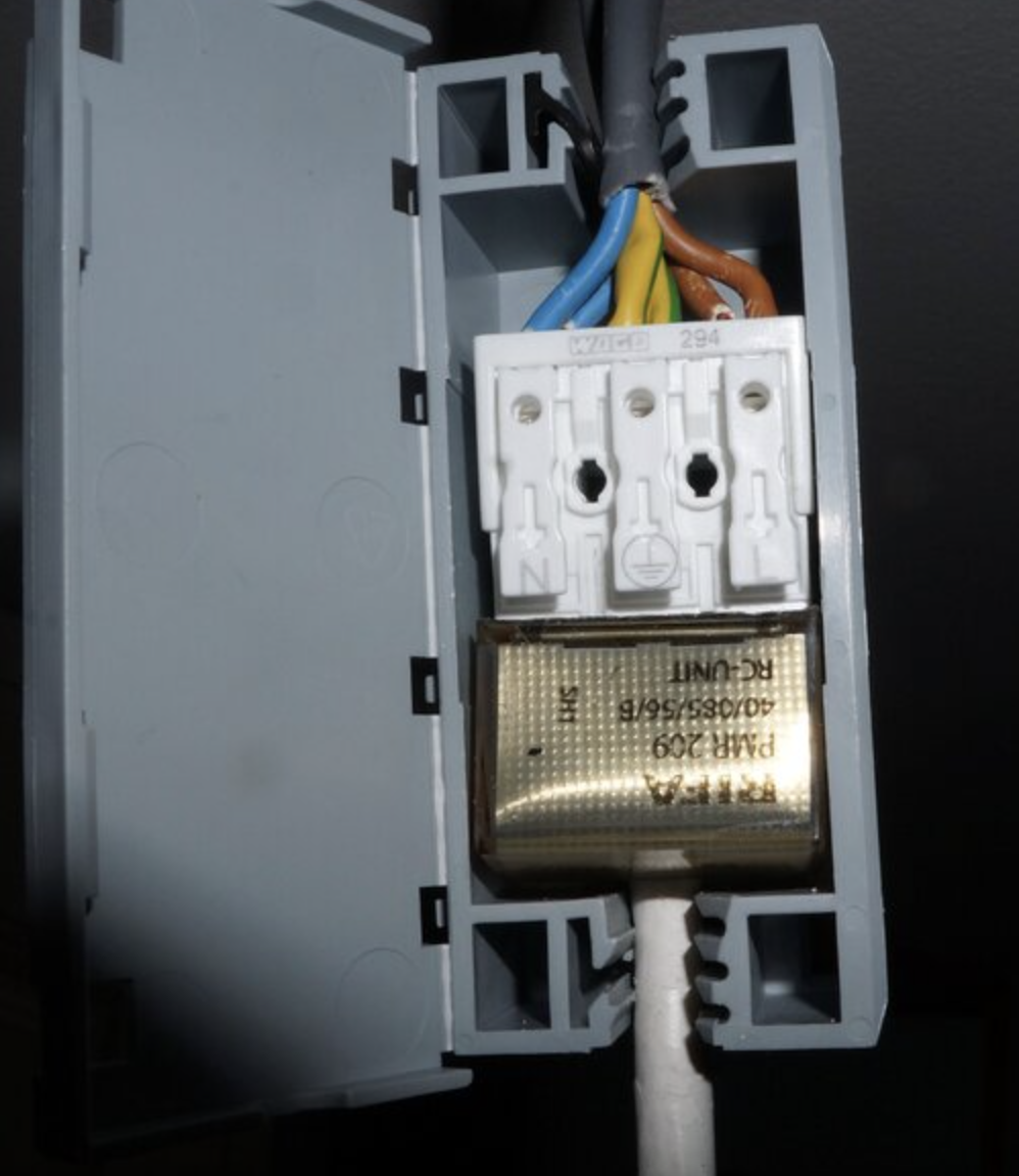

Yes, the cap and resistor are in series with each other. Connect the series pair across the load (effectively in parallel with the lamp).
Here's one, fitted.

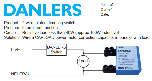

This is the standard idea, however it would require you to modify the lamp.

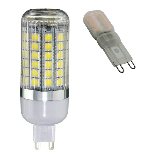

I had the problem with a chandelier in my wife's bedroom, I was using an electronic switch, I tried using the capload shown, it did stop the lamp staying on dim, but it then started to shimmer when turned on, since using G9 bulbs, I could change them, the much larger bulb shown here worked G9-comp.jpgone failed, and I opened it to see how it worked, the smoothing capacitor was nearly as big as the whole of the smaller bulb, on latter units I used a TP-Link (Tapo) switch that uses batteries, that also worked, but in your case you're leaving the switch on, so not down to the switch or cables, it is simply a faulty lamp.
View attachment 351221 This is the standard idea, however it would require you to modify the lamp.
That is normally the problem where a cable comes from lamp to switch, but in this case, the switch is not used if I am reading it correctly, but left on, and the switching is done inside the lamp, so the lamp is faulty, same as using a smart bulb, and that staying on dim.
I had the problem with a chandelier in my wife's bedroom, I was using an electronic switch, I tried using the capload shown, it did stop the lamp staying on dim, but it then started to shimmer when turned on, since using G9 bulbs, I could change them, the much larger bulb shown here worked View attachment 351222one failed, and I opened it to see how it worked, the smoothing capacitor was nearly as big as the whole of the smaller bulb, on latter units I used a TP-Link (Tapo) switch that uses batteries, that also worked, but in your case you're leaving the switch on, so not down to the switch or cables, it is simply a faulty lamp.

The light is on a relay that is controlled by a remote control receiver unit. There is a wire between the receiver and the light fitting (live, neutral, earth). I can install the snubber there with minor modifications.
