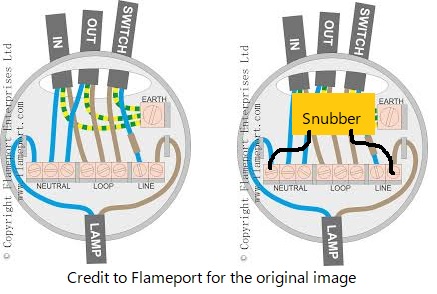

I have led down lights in the bathroom ceiling which glow when they are turned off, also in circuit is a extractor fan with a permanent and switch live
Any ideas ?

There is capacitive coupling between Live and Switched Live in the wiring to the switch, this allows a small amount of power to bypass the switch ( when OFF ) and an LED lamp can glow on this small amount of power.
This leaked power can be absorbed by a snubber connected across the lamp
Capacitor 0.047uF micro Farads 250 volts AC in series with Resistor 100 ohms
Which come pre-packaged as a contact suppressor from RS Components.
As a contact suppressor it would be fitted between Live and Switched Live at the switch BUT as a snubber it has to be fitted between Switched Live and Neutral at the lamp..
( If there is a Neutral at the switch it may be more convenient ( space wise ) to fit it in the back box of the switch )

How would that be fitted in a normal light fitting?
There will be a terminal block where the cable connects to the lamp. It will be either in the ceiling rose or in the lamp itself.
One lead from the snubber into the terminal with the Neutral and the other lead into the terminal with the Switched Live. If necessary put some sleeving on the leads to prevent short circuits
In the ceiling rose it would be wired liked this ( thanks to flameport for the excellent image of a ceiling rose which saved me having to draw it )
