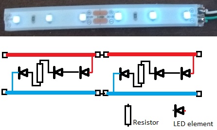

Being pedantic...
A driver drives a set current through the LED elements.
A power supply supplies a set voltage to the LED elements and their current control device. ( in LED strip the current control is a resistor )
Strips rated at 12 volts can be adequately bright when run on a lower voltage supply and will have a longer life time.

Being pedantic...

You'll find that the majority of LED stuff is 12 V, 24V is far less common. Tape is universally voltage driven (with on-tape current control) because of the many parallel sets of LEDs. For discrete lamps, it's very common for them to be a set current (e.g. 350mA) and you connect them all in series to a constant current driver - this gives more reliable control of current but is only practical for small numbers of lamps. A constant voltage "driver" is more commonly known (outside of the LED lighting market) as a "power supply" as Bernard was pointing out - actually I don't think it's being pedantic to mention that.
