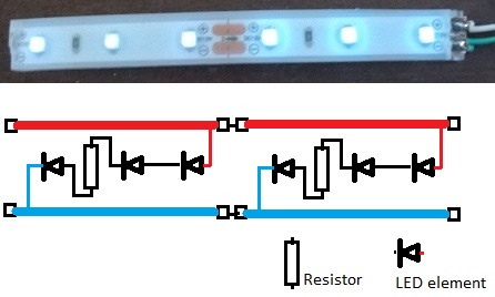

i have used a lot of LED strip from
https://integral-led.com/en/catalog/node/led-strips
which is one of many sources
Can be cut into short lengths, multiples of 3 LEDs ( 50mm per section )
Very bright on 12 volt. more than adequate light for under cabinet lighting when supplied with 10 volts and also a much longer life.

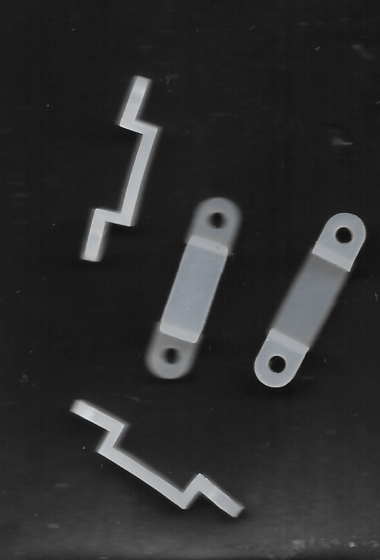

In a kitchen or other humid area I tend to dis-trust the adhesive backing and use these clips as a back up.
upload_2022-4-11_12-47-26.png or
