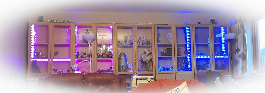

I can manually turn on the main lights, but the rest I rely on the Nest Mini's to control, yes there are buttons, but not easy to reach. The controls here 20230227_170703_1.jpgare on top of the display cabinet, I would need a set of steps to manually control.
