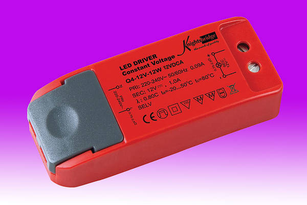

Beware the description "LED Driver" An LED driver will be designed to drive a set current through the LED element(s) and it will set its output voltage at what is necessary to drive the rated current through the LED element(s)
If the LED strip is like this
then you will need a fixed voltage 12 volt DC supply ( not a driver ) and let the resistors in the LED strip control the current.
Unfortunately many manufacturers of power supplies for LEDs label their products incorrectly.
A true driver ( fixed currrent, variable voltage ) is likely to destroy an LED strip

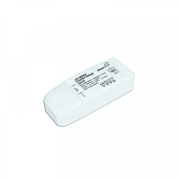

It'll probably be labeled up on the manufacturer's sticker as a "Constant Voltage (CV) LED driver", Bernard, and while we know thats just a regulated power supply and not a an LED driver in its true sense which usually gets described as "Constant Current (CC)", that seems to how they are described these days, and I'll leave any arguments to the Pendants on the the forum....
I agree but there are many PSU's labelled as 'Constant Voltage LED driver' or something similar.
from TLC
From Downlights direct.
All the time the manufacturers appear to be getting it wrong, what chance does Joe Public have?

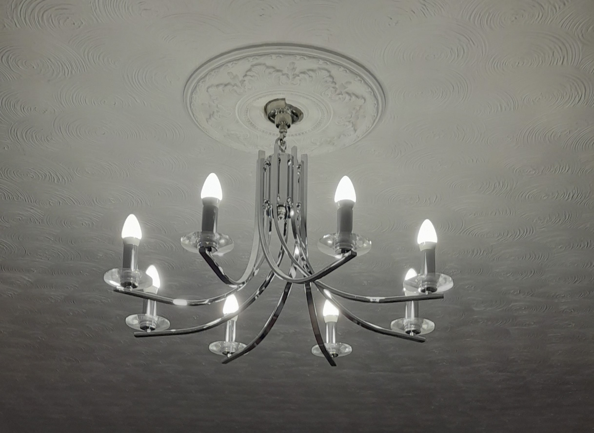

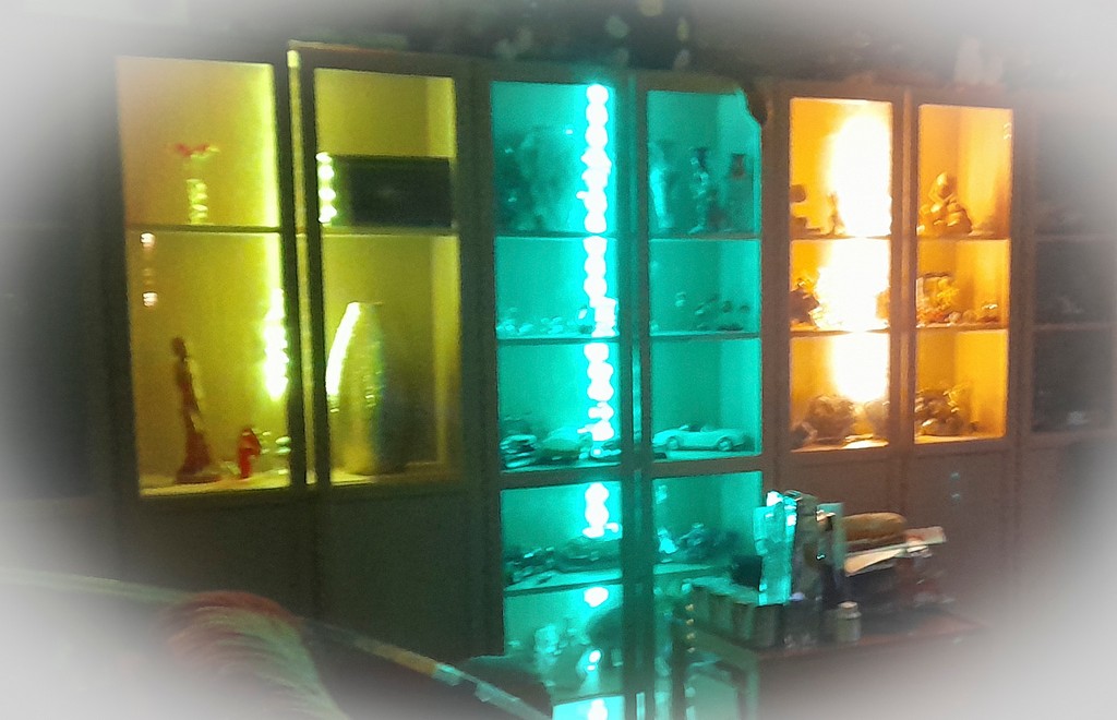

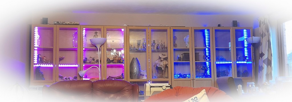

Wiring in series with a driver does reduce the volt drop problem, with DC low voltage starts at 75 volt, so most will be designed to work under that, and a typical white LED is 3 volt, so 25 LED's would be the max number, which is not really what is wanted. So my own display cabinet has three independent light strips 20220704_220311_1.jpg I changed the out ones, 20230227_170703_1.jpg for a longer set, (5 meters) centre still the original Lidi lamps, (3 meters) so 17 watt outer and 22 watt centre, and when set to full and white, they supplement the rooms lighting, for that size of room the non central chandelier is not enough 20220415_000328_1.jpg how the builders ever thought one ceiling light would be enough I don't know, the original 100 watt bulb was like a tocH candle in such a large room. (22x18 foot)
The switching on is easy, if you want more light, one can easy switch on an uplighter, or display lights, it is on leaving the room the problem arises, your left having to walk around the room, turning them all off, cure was to use smart lights, so 'hey google turn off living room lights' turns them all off, or on of course. I can also change how bright, and colour temperature and colour.
So I have to use the power supply which came with the lights, I did at one point use a smart socket with the original Ikea outer lights, but had to access the power supply to alter how bright or what colour, and power supplies on the top of the units out of view, so that was a pain.
Also often only use right hand side set, next to dinning table, so having them split into three works well.
