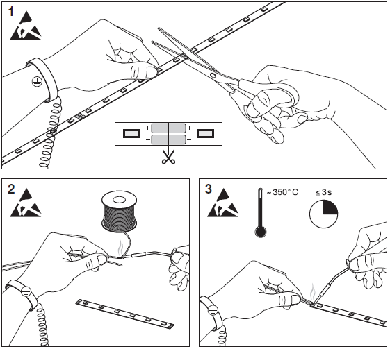

From a PDF on OSRAMS website:

That is what I think is odd, and what confused me. I have just checked again, and there ARE cit marks, which I used for the first section, but there are definitely FOUR flats at all of those points - but TWO at each end of the roll.
Have a little practice with your soldering iron. Or if you are currently a fire fighter take it into work, one of your colleagues is bound to be confident.

Osram do a special connector, at about 3x the normal price plus P&P, so maybe they fir the four flats?
