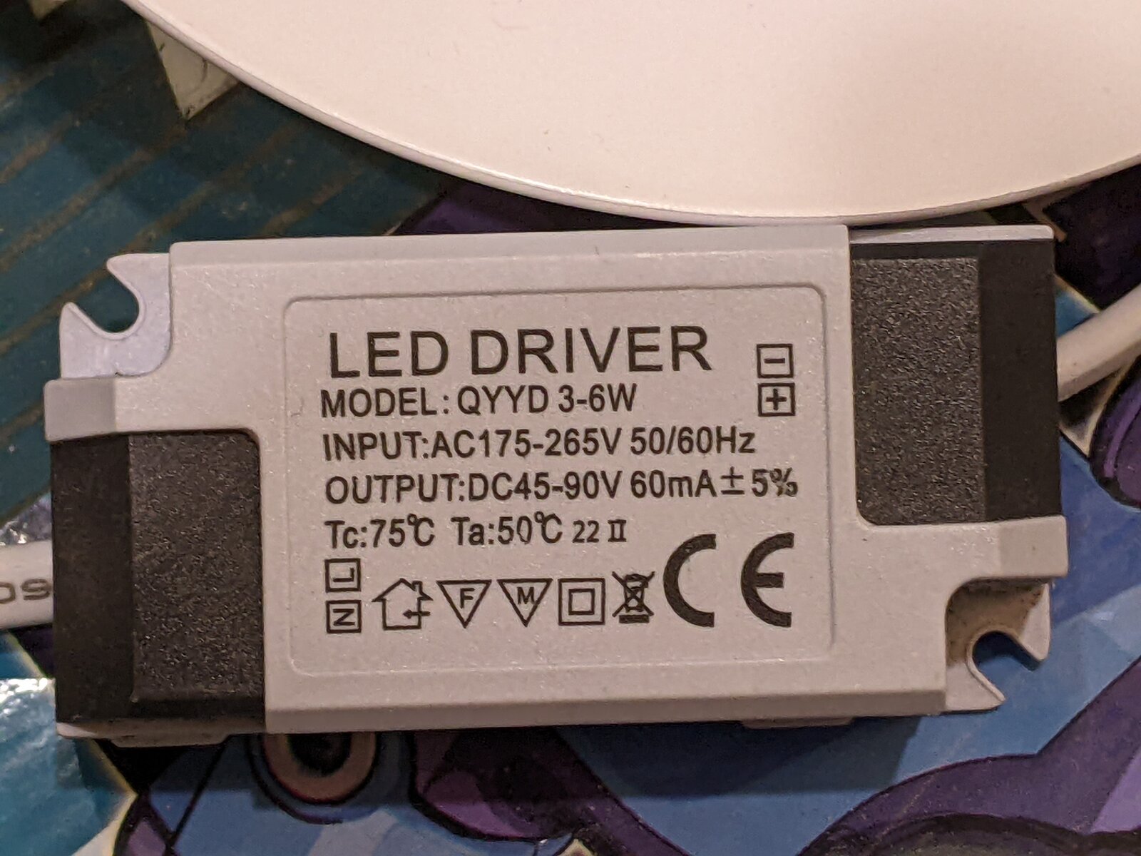

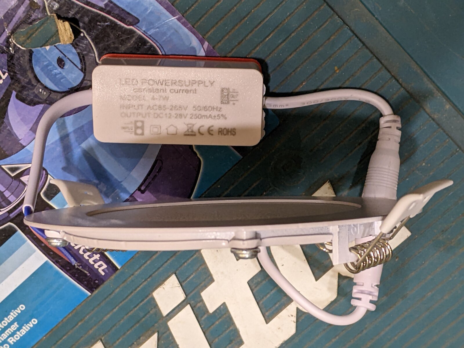

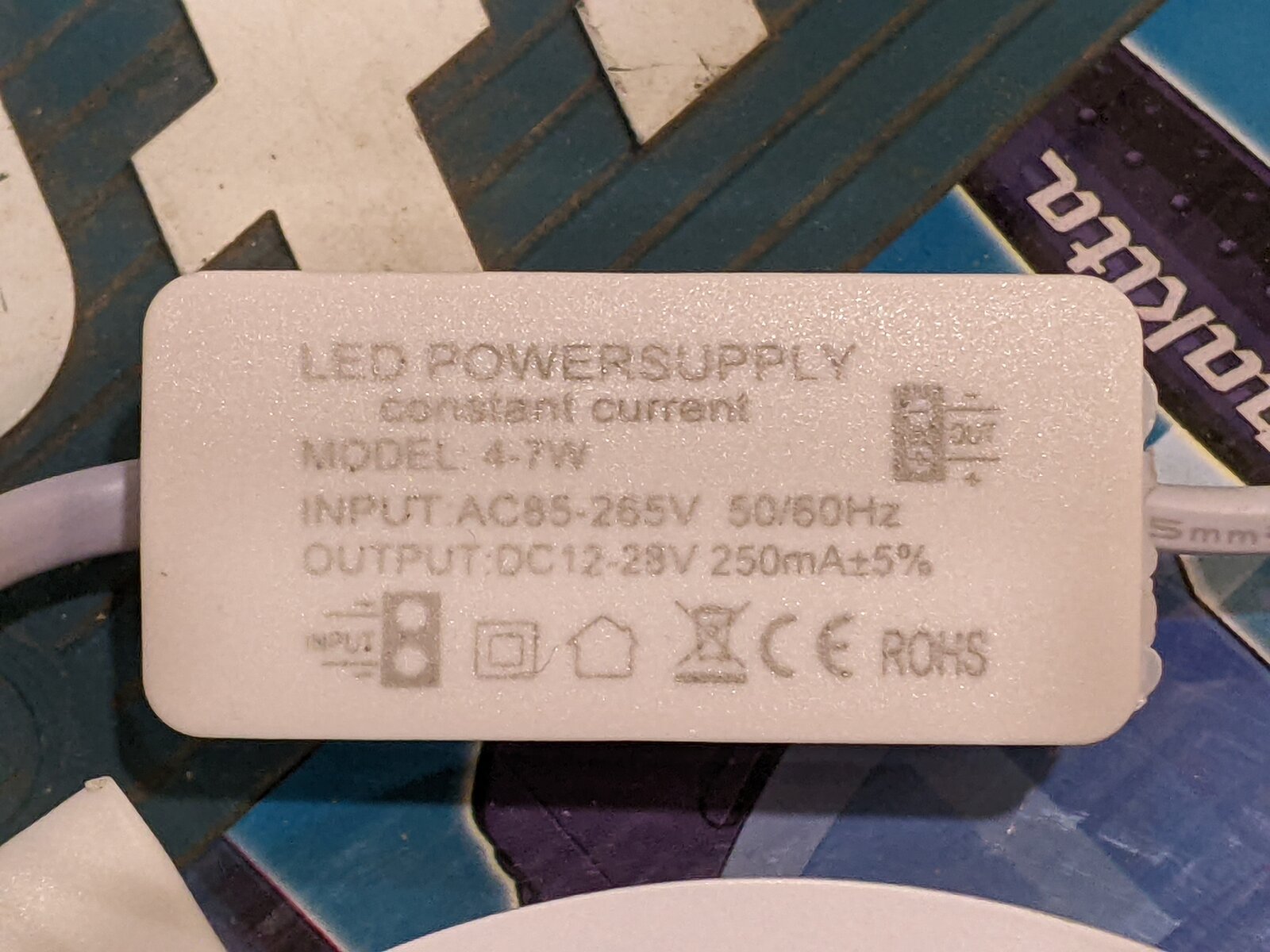

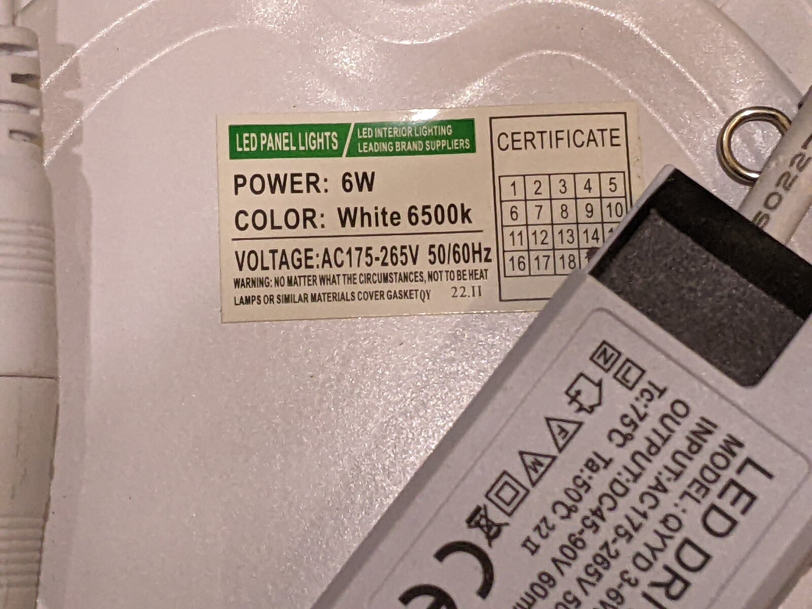

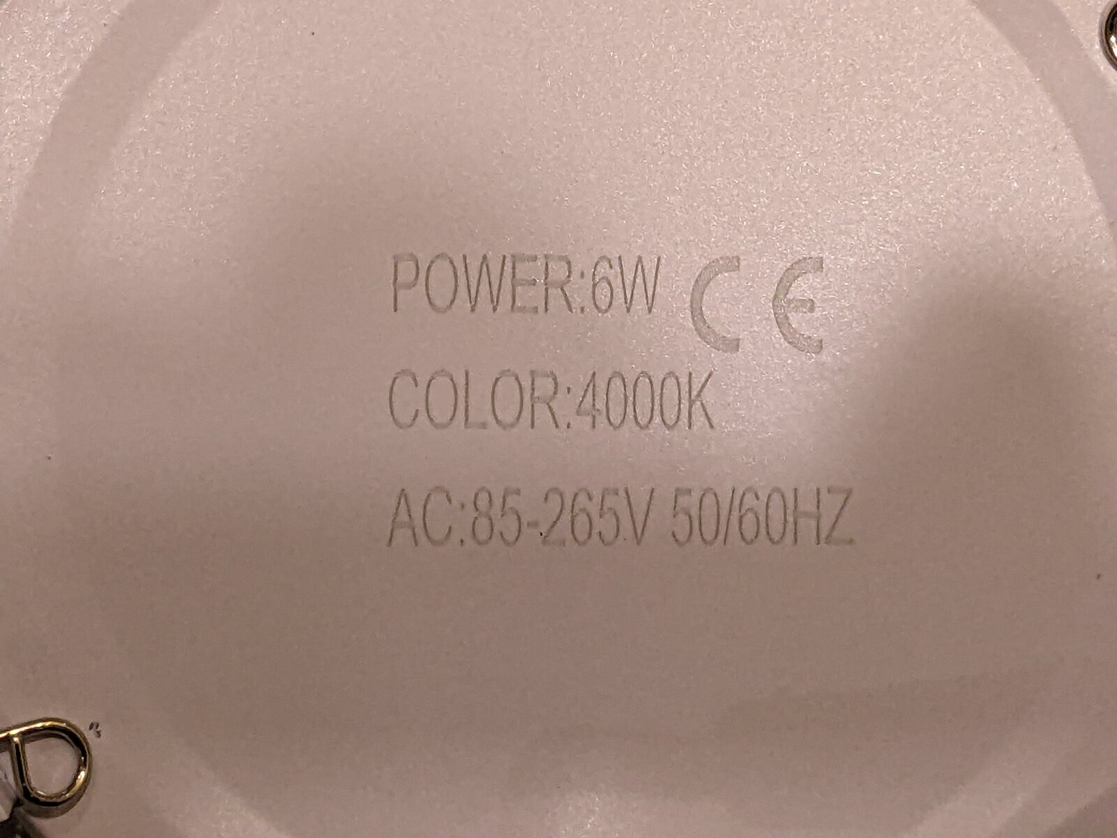

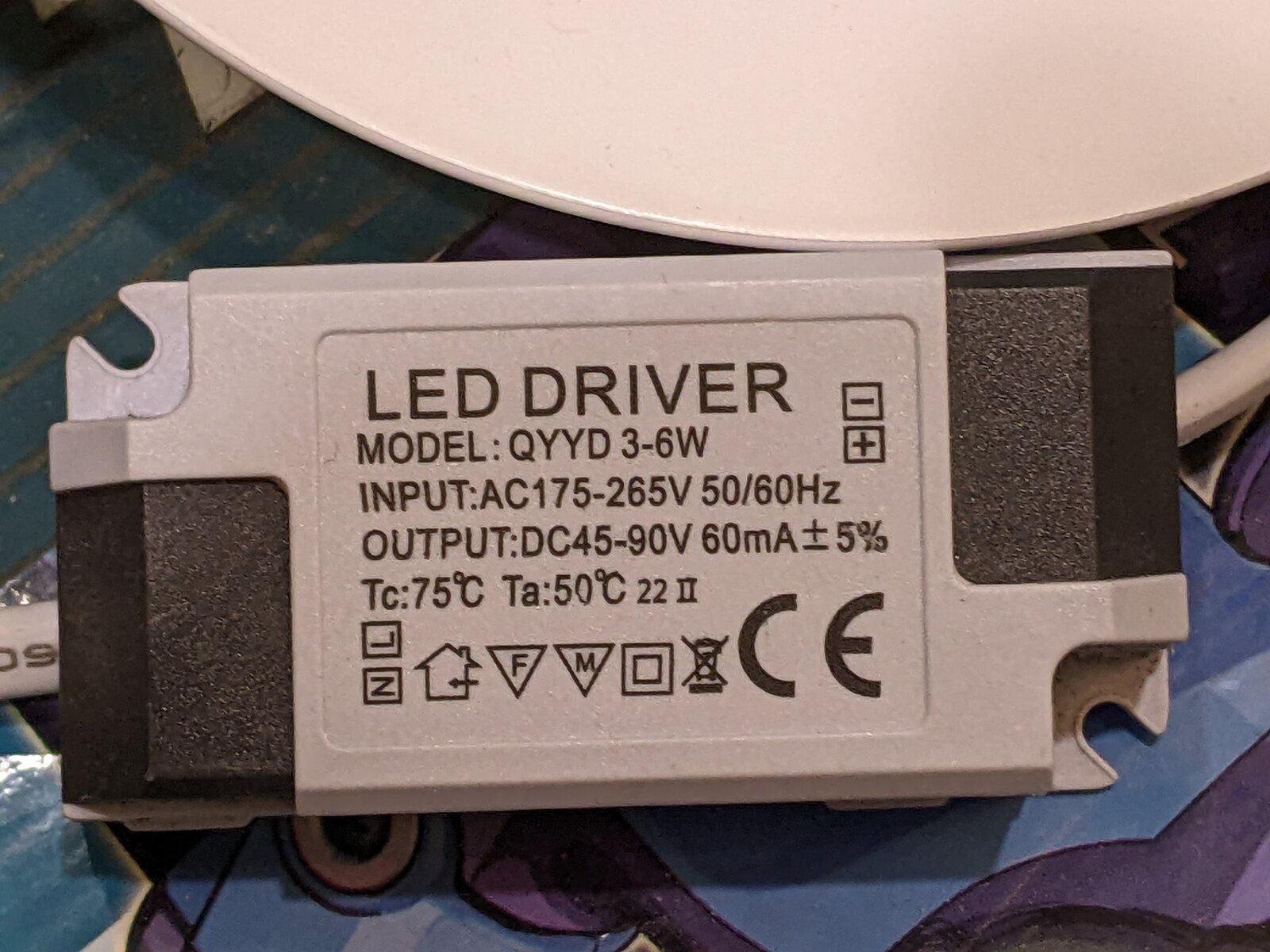

As mentioned earlier, I bought sets of flat panels 3 times trying to get the brightness and colour temperature just right (once 3W and twice 6W). So I've just tried swapping a 6W driver with one from the other 6W set (they both have the same power connectors, shown in previous post) ...and it didn't work, not even a flicker.
This is from the set I want to use:
And this is from the other set:
I'm very surprised, and now a bit reluctant to buy dimmable drivers. Is there an obvious reason the swapped driver wouldn't work?
However you may find that a separate driver exceeds the cost of buying a complete new panel with dimmable driver.
Yes I think you're right. I only paid £19 including delivery for 10 x 6W panels & drivers.
My dilemma is that I need this type of ultra-flat panel to fit over joists, and there are plenty of UK eBay sellers, I just can't find any that state their item is dimmable. Well I did find one but I'm sure it's an error, I asked and he didn't reply.
They are both "constant current" drivers.
One is a 60mA driver (@ 12 to 28Volts dc),
And
One is a 250mA driver (@45 to 90Volts dc).
Although both 6Watt, they have Very different current outputs that are related to how the LEDs are wired inside.
If you were to buy a replacement, using the first one as an example, you would search for "constant current driver 250mA" and then look for one that is actually dimmable and that is rated about 12 to 28V ( slightly off voltage is okay). I hate doing this as it typically takes far too long.
