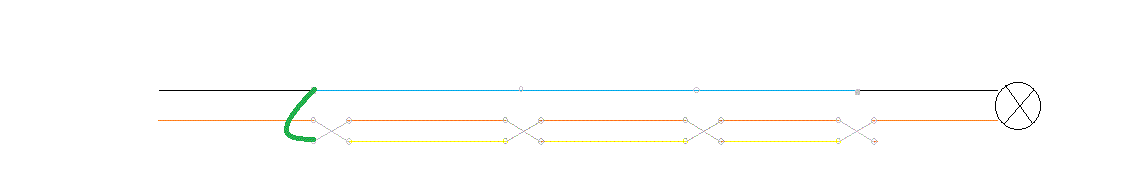

Just changed some fittings with G9 LED's on 2way circuit with 2 intermediates and of course they glow when switched off.
As it happens all 4 switches are intermediates and the neutral runs all the way through the 3c&e, I've added a 47KΩ resister (shown as dark green wire) which I happened to have with me, as a solution. I hesitate to just use straight neutral incase there's any contact sequencing problems with any of the 4 switches.

a very limited life expectancy, at 1.26W
but by using an intermediate switch at the location of the resistor the resistor cannot become connected between Live and Neutral unless there is a failure in one of the switches. There may be very short durations while the switch contacts are moving
Yes, I hadn't thought it though enough and, on reflection, I think what you say is correct. So why did you say (which is probably what 'put me off' :) )"A capacitor in series with a resistor would be safer than just a resistor as it could withstand mains voltage continuously without over heating."?
Kind Regards, John
Because in the event of a faulty switch that put 230 volts across the resistor there would be bit of a bang as the resistor disintegrated
Fair enough, albeit that's a very unlikely scenario - but I doubt that the failure mode would involve any significant bang - just a little smoke and smell, and maybe a fairly gentile "phutt" :)

As it happens in hindsight I think it is more likely to be smaller than 1/4W.
When BAS asked the power rating, my initial reply included the explanation that it should never have mains across the resistor. I then deleted it accidentally and just wrote "1/4W" as I had already mentioned it in my OP.
It should have been so obvious to any spark that was the case except under fault conditions and even then for such a short duration that it will be unlikely to have any temparature rise. Under any greater fault conditions [faulty switch] the only likely result will be the loss of a 2p resistor and the symptoms will be the lamps glow again, indicating the something has changed. Oh and as already mentioned it may smell.
Originally I intended to put the neutral away directly but included the resistor to prevent a fault taking out half the house.
