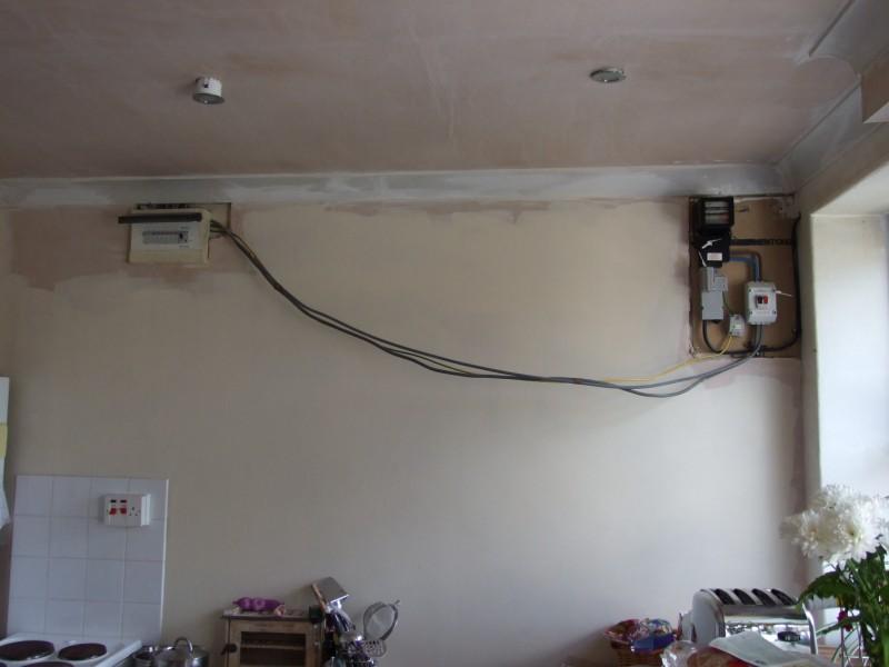

Hi Folks,
I fully expect to get flamed here, but I'll ask anyway :cool:
I need to run two new tails, longer obviously, to my new CU unit. Can someone tell me what the cable diameter/type is please so that I can order the correct stuff.
Pics :
Current setup
new cable run (in red)
CU Unit
Thanks in advance

nice job by the plasterer though, overboard a wall and plaster in the CU.. :rolleyes:
tails are usually 25mm² double insulated, one brown, one blue. earth is 16mm²
if that run is more than 3M, then you need to fit a switch fuse..
who on earth put the CU that far away from the mains anyway?

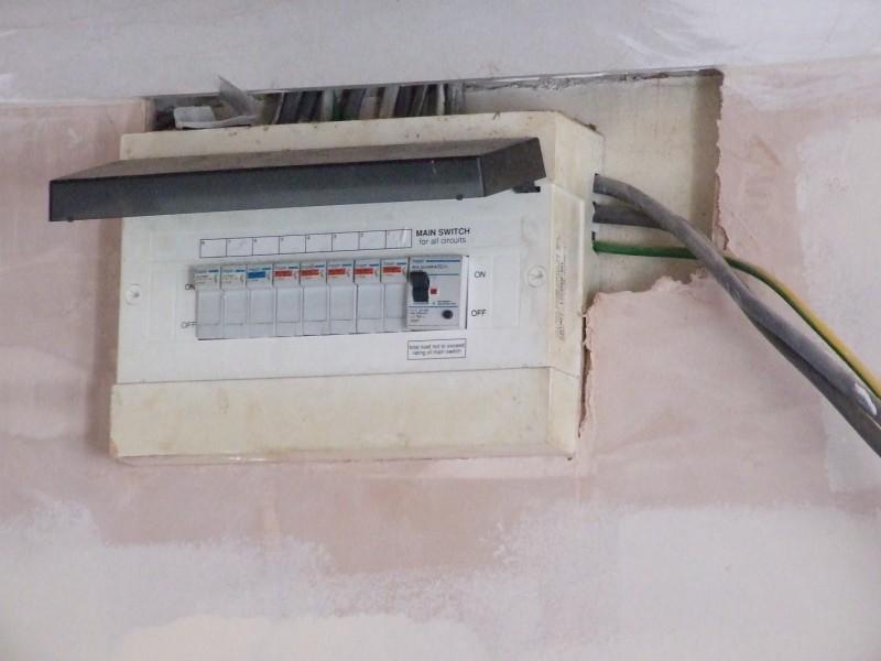

Did the electrician who fitted the consumer unit know it was going to be directly above a cooker ?
Both means of isolating a over-heating cooker are directly above the cooker itself.
Not good.

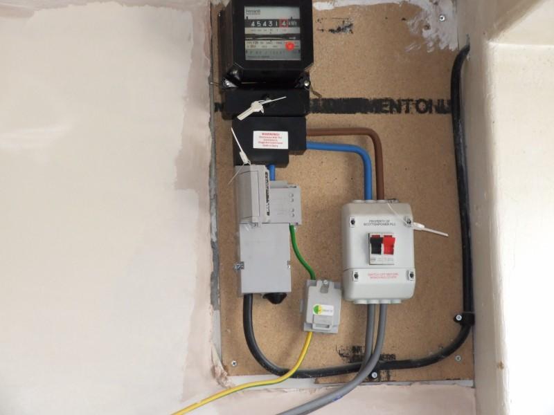

Ah not so bad... there is a third way to isolate the whole lot, lights as well, on the meter board.
It's more than 3m now, and will get approx 1m longer when the tails are replaced. Can you link me / give details of an appropriate switch fuse please?
Along story, but the mains used to be on a wall directly opposite the CU, approx 1m away. Scottish Power came ot remove mains from the wall that I was about to remove and put it there. They refused to place it anywhere else. Wouldn't mind but it cost me £180 :cry:
Yup, thats where I knock the power off when I am doing anything electrical.
Hope you lock off like me, too?
Rather than running the tails via the route in red, turn the isolator enclosure upside down (or replace it with a switchfuse) and run the new tails upwards and over the top of the meter. You may find you can then reuse the existing tails.
I agree with BAS - this is a job for an electrician.
Get a quote to get the CU moved to the meter, I know its £££'s but worth doing if you can, surely. And it looks like your getting works done so now would be the best time to do it (well before you plastered would be but dont let one mistake cause another, your plasterer will be able to patch it quickly enough)
You gotta be joking me - that thing isn't new!
Look at the state of it:
Don't know what size RCD it is but you shouldn't just have one of them protecting the whole building - section 314 of the regs refers.
never paid it much attention, but does that thing have cartridge fuses?
can't see any levers so it aint breakers..
That, and what you see on the meter board, is all I have.
Some of the things that spring to mind are reversing the tails, electrocute yourself, or not tighten a cable fully so it has a high resistance join.
Still I'd think twice about the location of the consumer unit - it probably one of the worst places to have it.
