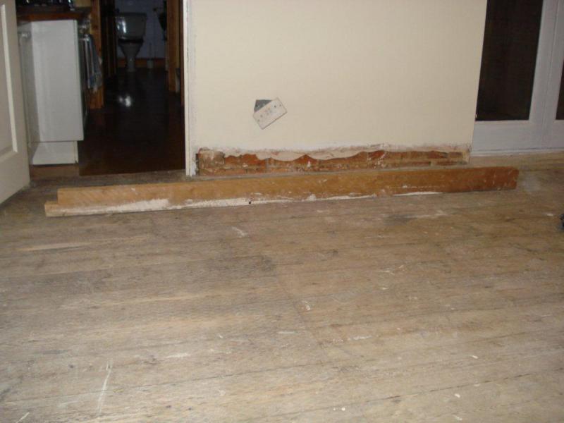

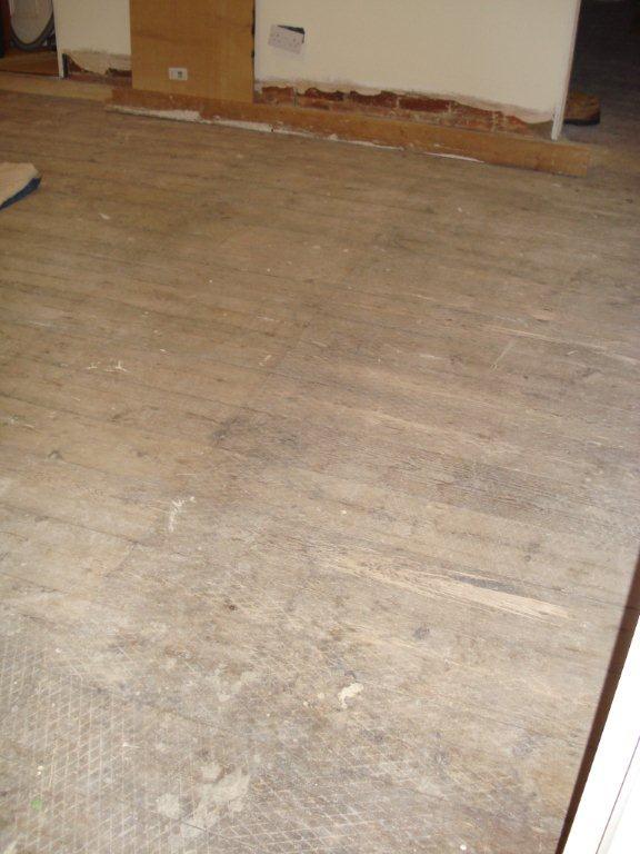

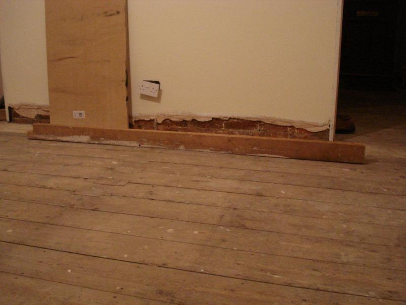

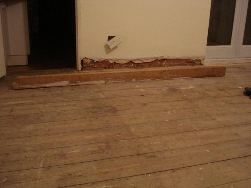

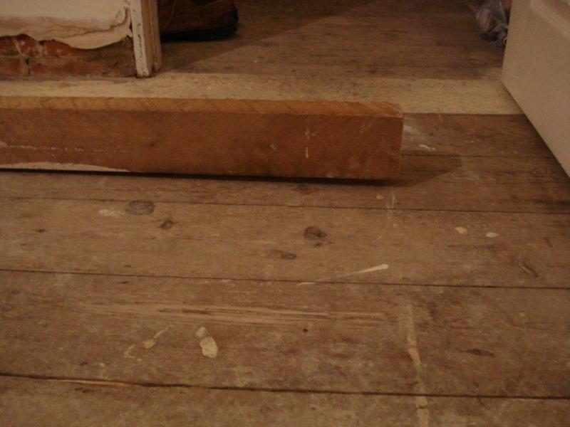

Hi people,
I plan to lay a solid floor into two adjoining rooms. They are only connected by a doorway. The rear of the house appears to have sunk by about 1" relative to the front and about 1" at the sides relative to itself. In other words there is a crown in the rear floor - or more of a fold, and another fold near to the transition between the two rooms.
I have taken a very amateurish survey of the floor using a piece of 4m CLS, which is how my measurements above were derived.
I have considered various options to remedy, but most of them will cause additional problems with things like cupboards and other transitions.
There's a few pictures taken with a 2m piece of timer over the crown.
I think, since the problem is more serious than I thought, I would like views of how to tackle this in the best - as opposed to the easiest way.

The front and rear floors are separate items. The front floor is 4" joists on 4" wall plates and is flat, with the exception of one corner which can be easily sorted with the method you describe.
The rear floor 4.2m x 3.2m is onto a wallplate one end - the low end (yey) and the other embedded into the internal wall which separates the two rooms. In fact it's two walls that separate the rooms, with the stair case running up between them. Anyroad. The rear joists are 7" with the boards straight on top. Under them in the middle of the floor, is a long piece of timber right across with a post under it - I know (since I cut it out tonight) that this was to stop the spring in the floor. (Floor now springs).
I realise now... silly me - that since this was resting onto a large retaining wall (in the bottom of the cellar) that the floor has bowed round this post, hence the fold in the floor!
When I removed the post and lowered the acro props, the floor moved, not one iota. I suspect since it's been in that position for years it's taken a permanent set. Therefore if I were to use an acro and raise the joists as you suggest I suspect the floor might try to retain it's "bananna'd set".
