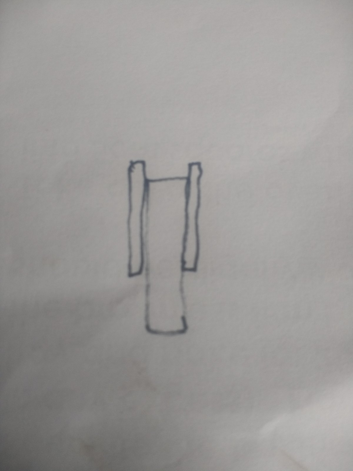

Hi guys
Victorian house, sloping floor to one corner of room. Room approx 3000 x 2800 Current joists 200 x 50 at 300 spacing and seem sound. 10 joists in room with a span of approx 2800. Some movement in the walls years ago has caused the slope.
Question 1 is, is it ok to sister new 150 x 50 joists for approx 75% of original length to these to level out. i.e smaller than the originals to make it easier to get them in. Then chipboard floor on to new with load transferred on to old?
Question 2 - planning on M12 coach bolts, what spacing?
Question 3, is this notifiable?
