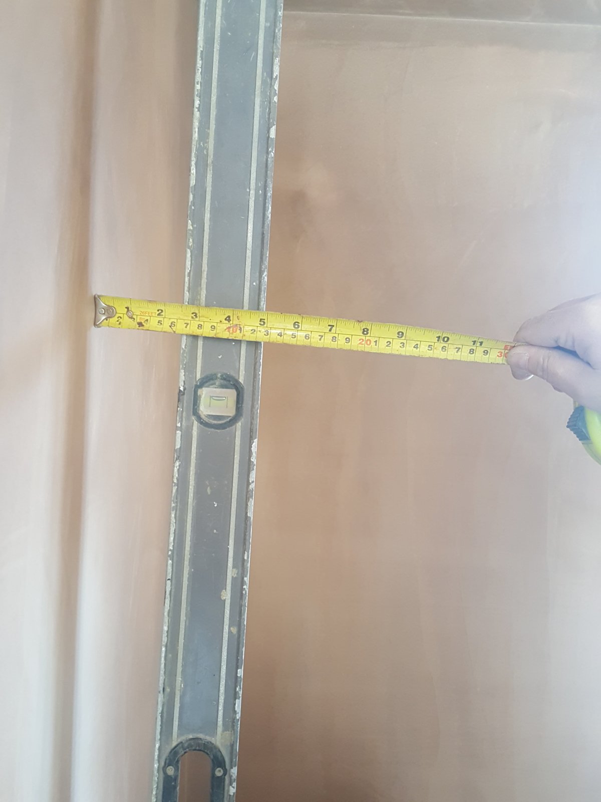

The project is a conversion of agricultural building. The external walls are not plumb. External walls have battens then 62.5 mm Kingspan insulated plasterboard, and 3 mm skim coat.
The walls are not plumb and no allowance has been made to correct this by spacers on the battens,
I sh*t you not!
The builder initially claimed the Architect instructed him to ignore the level of the walls. He is now offering to straighten with a base coat.
The above example in the picture is extreme. Some of the other walls are only 20-25 mm out over the height of the wall.

That's farcical the whole lot should be taken off 3in Base coat on board? I reckon he's spinning you a you a yarn about the architect tell him you want a word with the architect see what he says ,what kind of wall is it ? Stone brick? Is there or was there render on it On the inside? What was the building a barn?
Yes. Definitely BS about the architect.
The building was a tractor shed. Double brick wall. No cavity.
He is now saying that he will correct the worst bits. The bits on the picture. Other walls are out by between 25 and 55 mm . His plasterer told him the base coat would be too thick do he is now saying he will put another plaster board on and taper and skim over that. Would that be acceptable?

Not really I think any corrections will be a botch job there's only a couple of ways to do it and not ideal they could fit battens on the battens or cross batttens with the spacers you mentioned attempt to dot and dab, floating is a no, build a stud wall in front of it? Has it got windows? your within your rights to refuse
A carpenter could do it well by screwing battens in line and over the top of the existing battens, in wich case the new battens will need to packed out and or cut like firrings.
Or a carpenter with a site bench saw could counterbatten horizintally ripping down battens to thickness required.
Since the walls are plastered, Im presuming the 1st fix electics is already in place? If not then that should be done next before battening.
If the walls are all battened out properly, I csnt see a problem with leaving whats there in place. If its removed, a carpenter will have to level up the studwork anyway and the sheets would break up as they are taken off. If its left in place, you get another small cavity and an extra sheet of plasterboard.

What the Arc said is that he will specify a limit over which the wall will need to be corrected. He has suggested 20 mm which I think is very generous to the builder but actually I don't care as there is no wall which is under 20 mm. I cant find any reference to the BS standard you mentioned above about 3 mm over so many meters. The only standard I can find is from NHBC, and I think that would apply to only new builds which provides for 8 mm over the whole wall. The best wall is 25 mm out, and that is over 2 m, as I had a 2M spirit level. The walls are actually a little higher than that.
Many thanks for your advice chaps. I am now going to refuse anything being placed over the existing walls, as it sounds like that will be a bodge.
