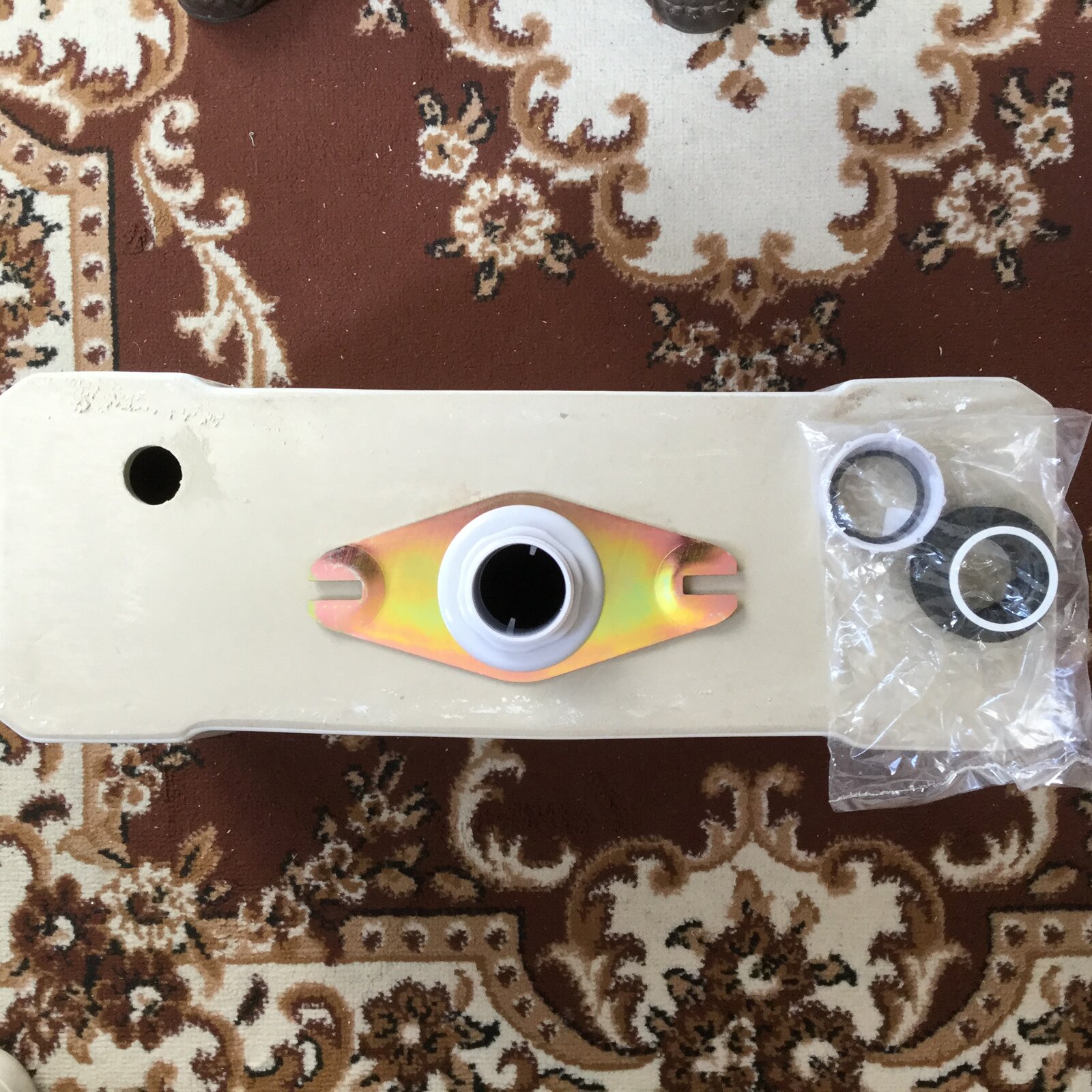

I have taken a photo of the base of the pan. I have Attached my last ?
They give you parts for both Close-coupled and low level cistern... It's a universal flush kit.
As @denso13 said, if Cc, you need the donut washer to sit round the backnut.
Smear the bolts and nuts with silicone grease or vaseline to protect from rusting.
Morning to you both,
Thanks for your continuing help. The part is in a sealed package an is labelled “ Kit for low level installation” so I take it this is not used unless you have pipe work running from a cistern above or higher than the cistern. Thank you for mentioning Vaseline (never thought of that) all I see in the DIY stores is silicon sealant ? Years ago you could readily go out and buy a tube of silicon from the bog standard DIY stores - I am keen to get these parts smeared as I have in the past had to hacksaw off the bolts due to the wing nuts being corroded
Your cistern is Close-coupled, it sits on the pan. You do not need a flush pipe, flush cone or compression nut and washer for the flush pipe... These are all for low-level cisterns.
But you do need a donut washer and this may or may not be in the kit... It should be, but manufacturers have weird ideas these days and different pans require different donuts, so they usually opt for not including one... This is certainly true of some cc kits you can buy separately :mad:

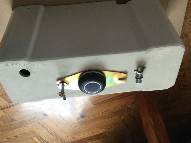

Not to spoil your Sunday - it looks as though I do not have a dough nut washer which came with the kit. This would sit between the pan and plate ? I suppose it’s roll would be to prevent friction between the pan and the plate - the dough just sits on the plate or clamped and compressed by the plate and the bolts. will I
take a pic which might help ? Regards. John
Ok I have taken a pic with only slipped in the one bolt and the doughnut on top. I think the doughnut goes
Between the plate as previously mentioned Sorry this is upside down
Thanks just picked up your reply - I definately did not get a washer that would sit between which now would be the doughnut base of the cistern and the clamping plate
So what you are saying the clamping plate does not compress the doughnut - I looked at the link you sent
Of the tool station and see the doughnut but not a nylon washer ? As you say the pic I sent is ok with the
doughnut sitting on top of the plate, I thought the installation would be 1. Nylon washer (sitting on the cistern. 2. Doughnut upside down next 3. Then the clamping plate ? Please correct me if I am wrong ?
