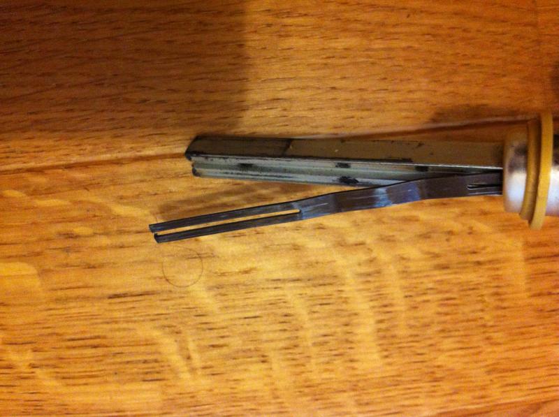

Hi all,
My front exterior door has a lever handle that started to pop out a few months ago. I've been slowly poking around trying to figure out how to fix it and I now suspect there was a set screw on the shaft of the handle that fell off and is probably now sitting somewhere inside my door. However, I am not sure (a) that this is correct and (b) what to do about it. I imagine it's pretty simple, but I just don't have any experience in this area.
I've attached some photos below showing the handle inserted into the door as well as the shaft on the handle itself. As you can see, the shaft has a square cross-section with a thin metal shim along one side. Two sides of the shaft have a groove in them, including the side with the metal shim. The shim itself also has a groove cut all the way through it.
The groove on the side without the shim has what appears to be a hole or gouge near the end of the shaft. Could this be where the set screw was inserted?
Thanks for your help!
rh
There should be a tiny grub screw put in with an allen key, it splays the split shaft/spindle which grips the other handle, my guess is its fell out
Thanks for the suggestion, but there's no hole for a grub screw anywhere on the handle or the shaft.
is there anything on the other side of the door?
Agree with John , door handle has failed retaining ring snapped or fallen off, should be a one piece handle, you will need to replace the handle unless you can replace the clip.
So long delay in coming back on this, but JohnD got it -- the grubscrew was on the other side of the door. Super-simple repair after that. Thanks all!
