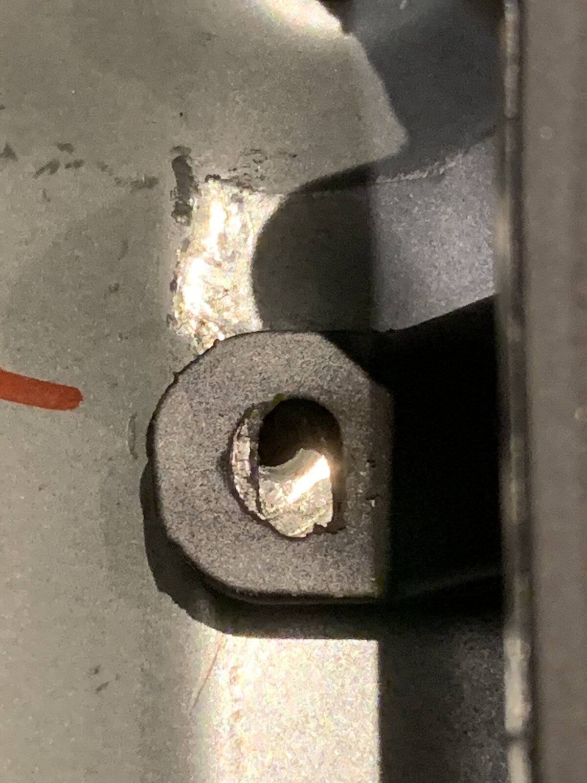

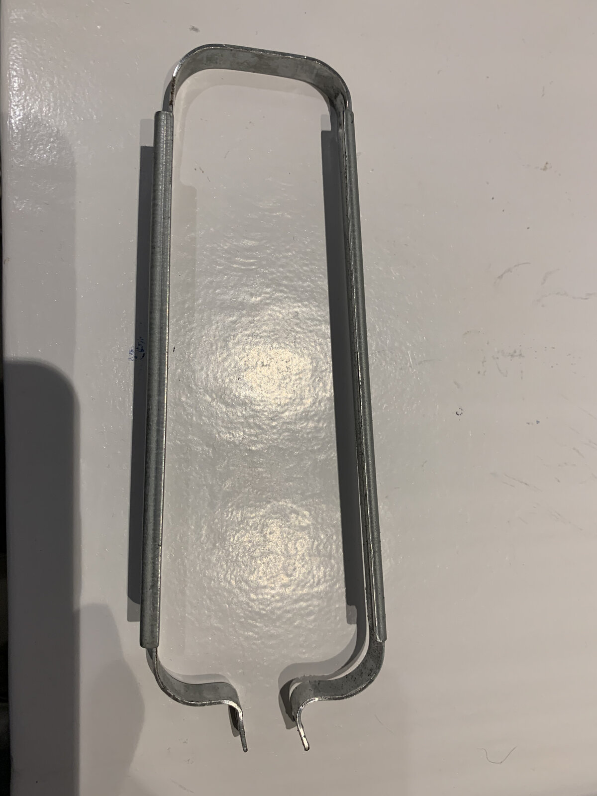

Removed the top cover today and everything was very obvious. Three missing screws ! Main culprit was the clamp tightening hot air blower to the seal, last picture. But I also discovered two screws connecting dryer assembly to the drum housing was missing as well, first three pictures.
What do you guys recommend here ? I am planning to replace the seal, as there are some heat damage already, and I think I can sort out the clamp using a new screw and nut. Unless you think this is a bad idea. What do you suggest for the other two screws ? Do I just find out slightly bigger ones ? Would loctite help in this kind of setting ? I'd like to do a long lasting repair if I can, don't mind replacing one or two more parts, within reason. Any recommendations are more than welcome.
