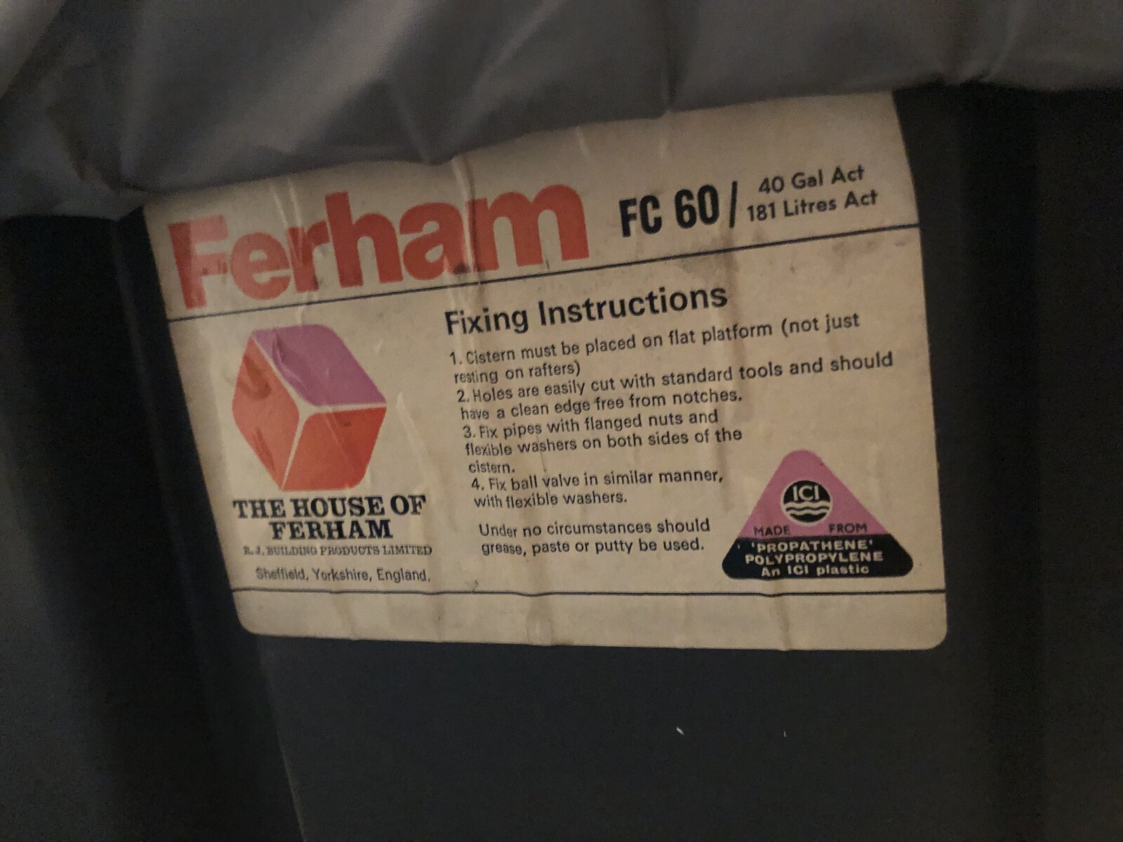

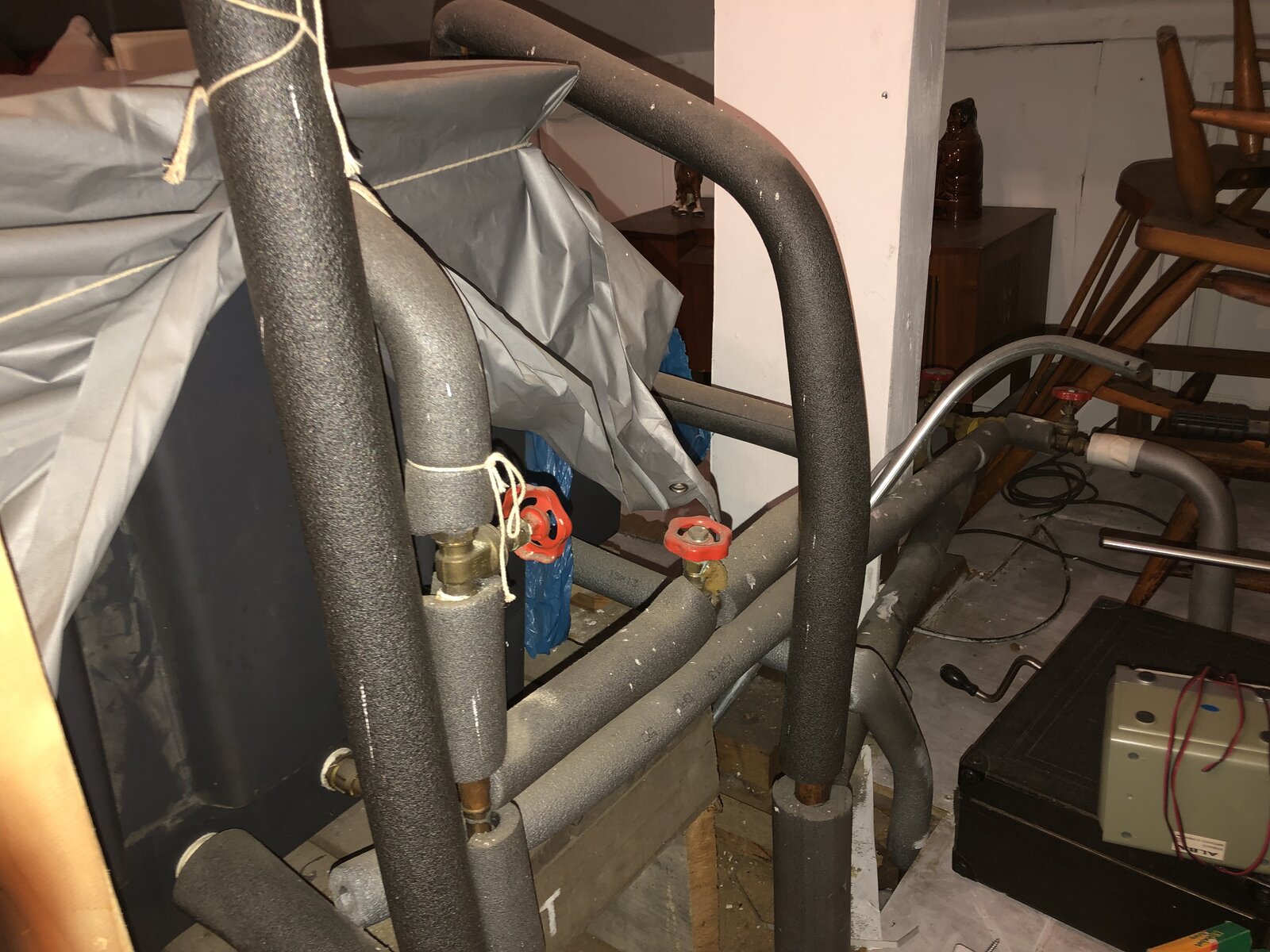

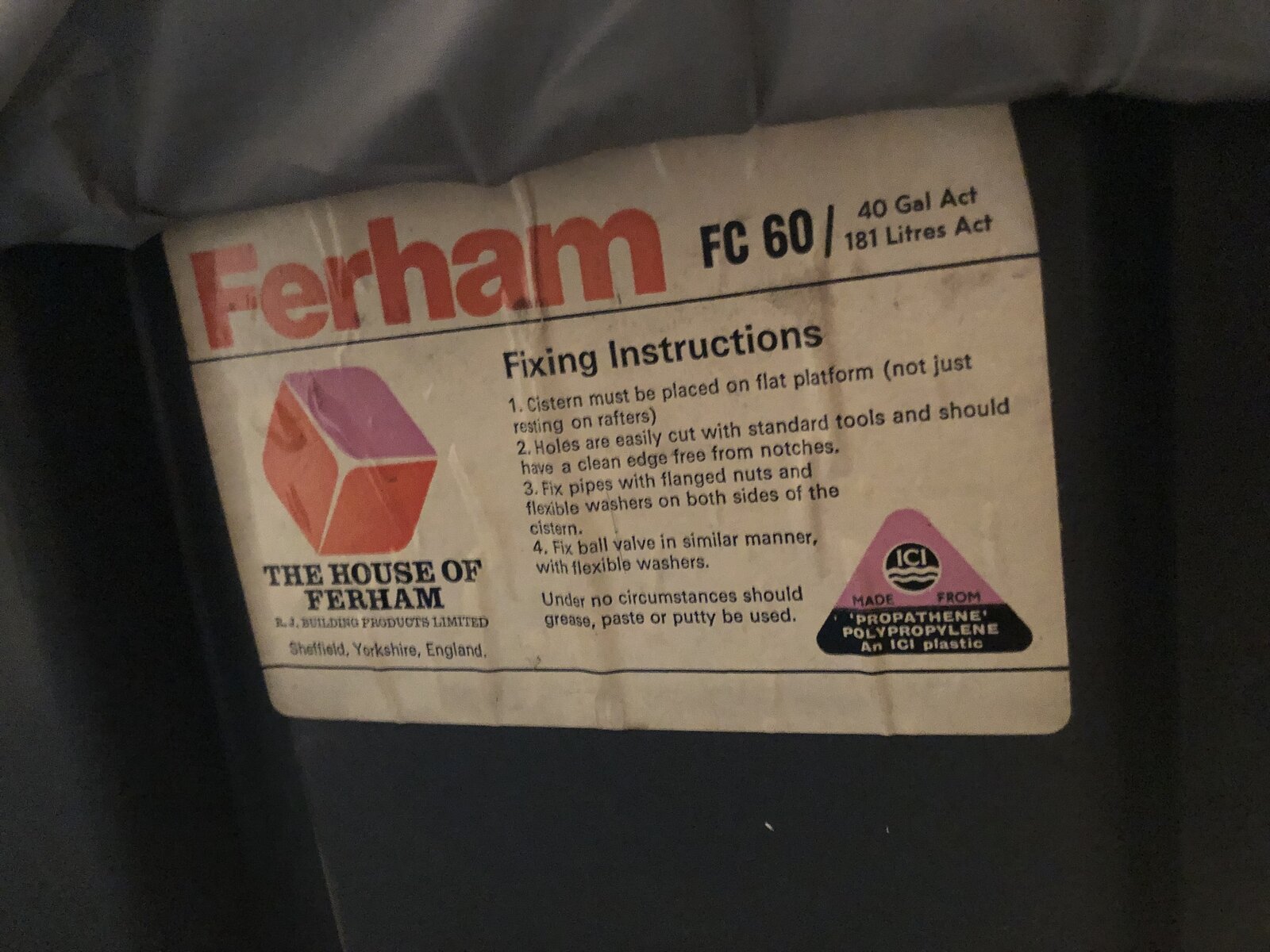

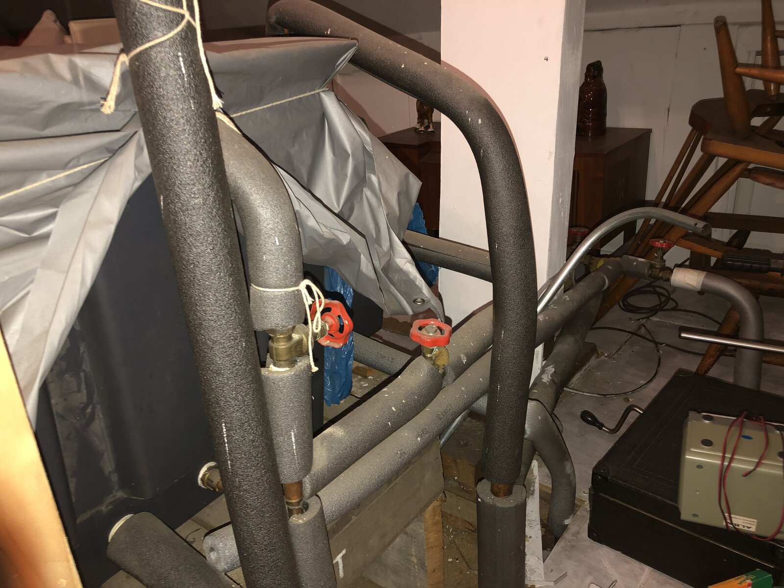

Hi all
I’m seeking a lid for my cold water storage tank
It’s a 40 gallon tank
I have attached an image of the tank model and the current non idea areangement

Why not contact BES for a "Tank lid for a 40 gal CWST" - also mention the shape & make of the tank.
I will be getting rid of my cold water storage tank but it's a round one. I think yours is rectangular but you haven't actually said.
I did look at the website and they didn't seem to show a FC60 model, I'm guessing it's pretty old.

You could get an unvented cylinder as suggested, but seems a large expense if you’re happy with existing setup. If you really want a tight fitting lid (water regs) then buy a replacement cistern. If not persevere with what you have and maybe fashion a lid?

I just didn't have a good constructive idea for a lid apart from a sheet of marine ply cut to size.
You need something impervious to moisture, so it will not rot - which probably means plastic. I would suggest soffit board would serve that function OK...
https://www.eurocell.co.uk/fascia-and-soffits/soffit-boards 300mm x 5m, cheap as chips, and it fits together, like floorboards, with a tongue and grove. It would need a bit of timber on fixed on top, to hold it all together, using stainless steel screws.
