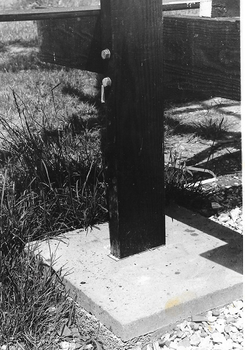

One of 20 posts in a post and beam house. 8 x 2 Oregon Pine
These were pressure treated with Tanalith in 1980 and are still in very good condition. The lead under the post seals the end grain to prevent water getting into the inner grain.
