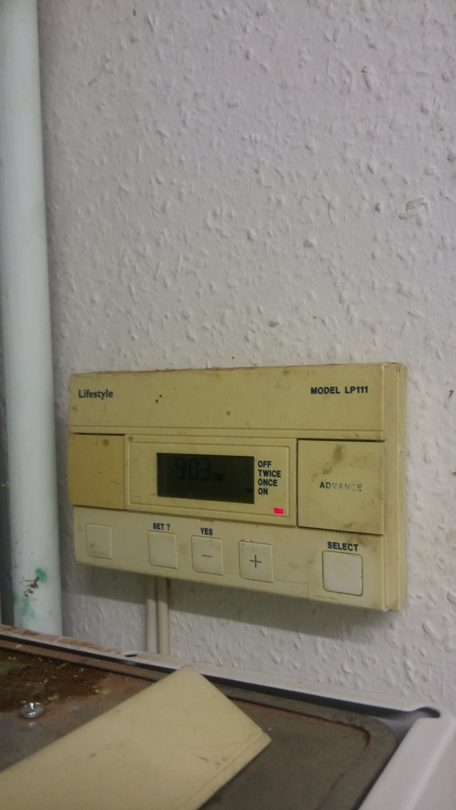

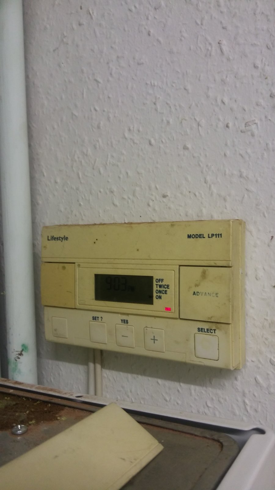

Lifestyle LP111 thermostat upgrade to Horstmann HRFS1.
28 Nov 2017

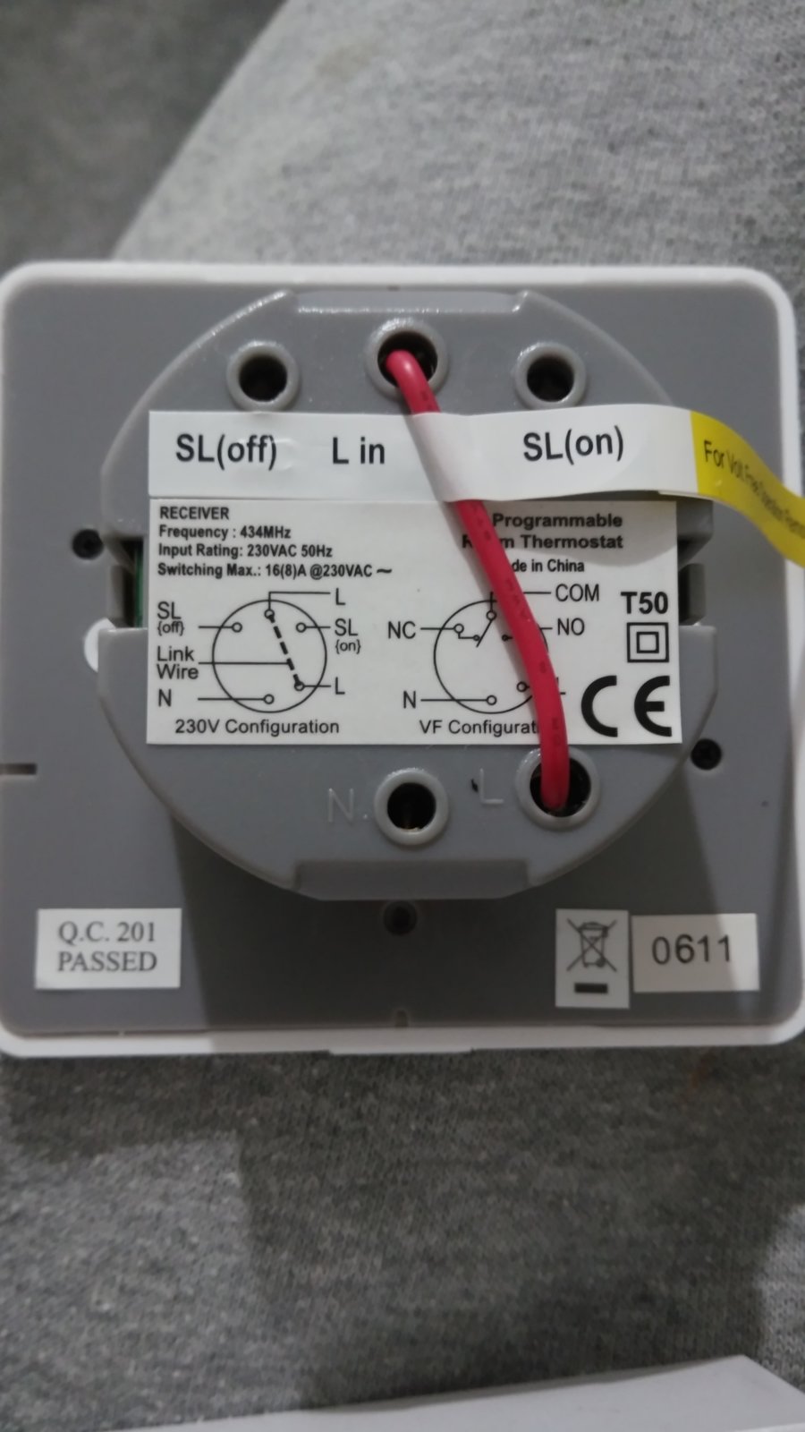

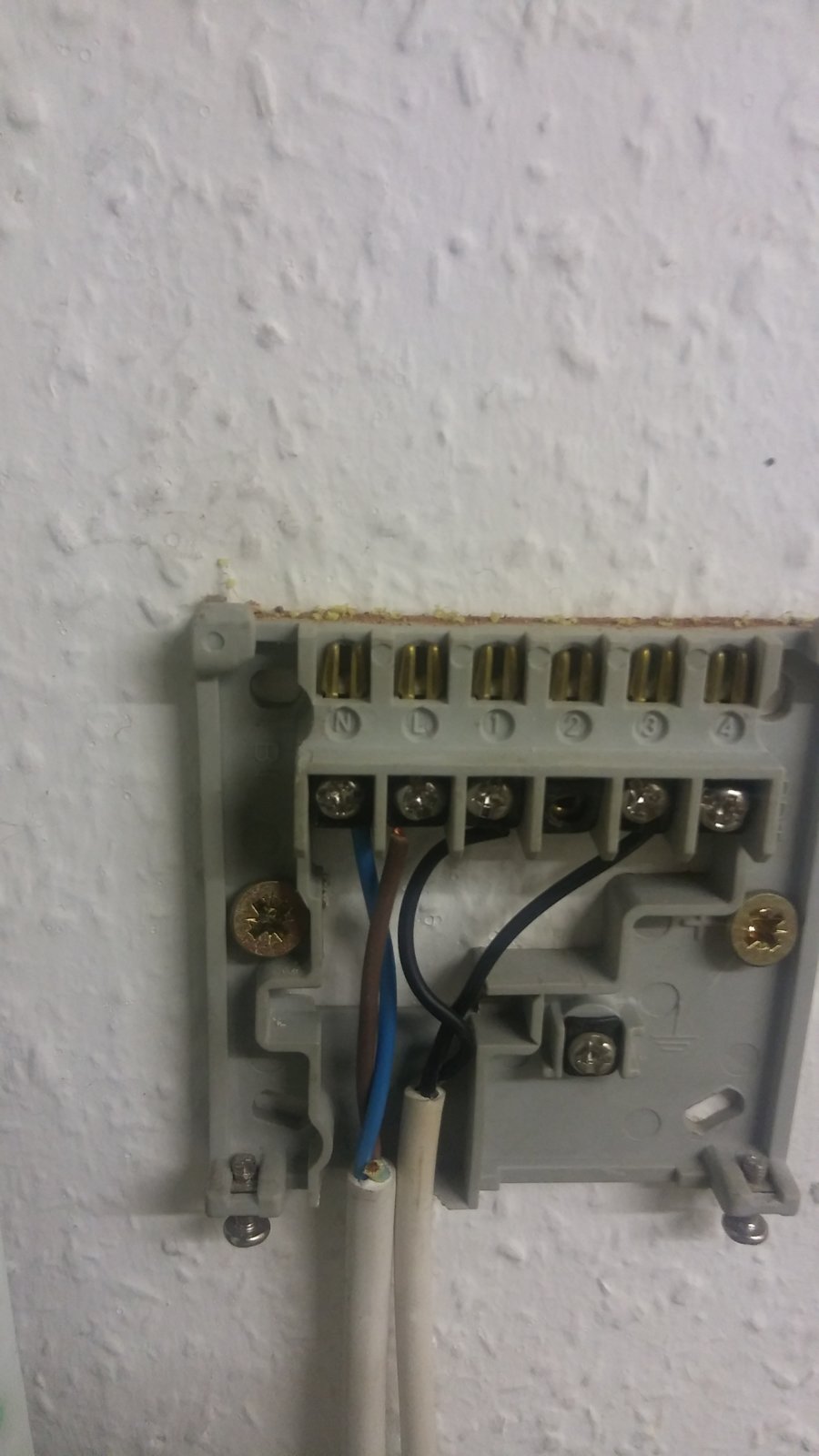

Hello
I want to install Horstmann HRFS1 but I am not sure how to connect the cables in new thermostat HRFS1.
Could explain me how to do it ? Thanks

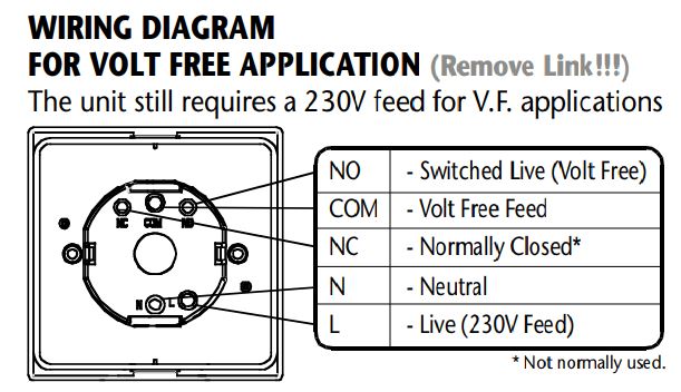

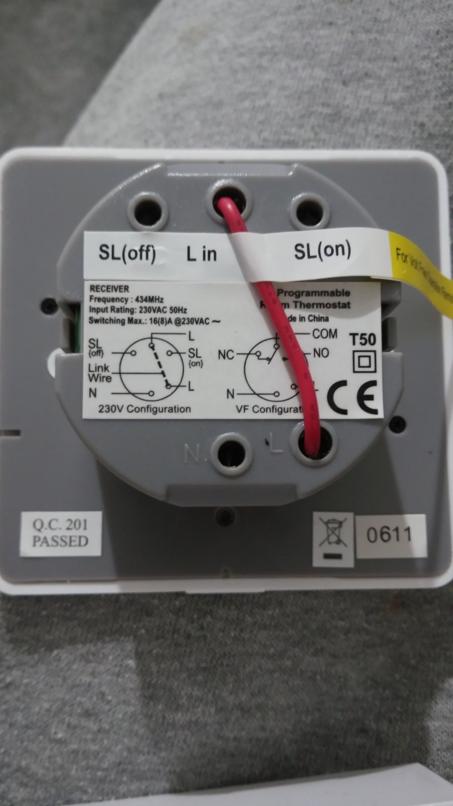

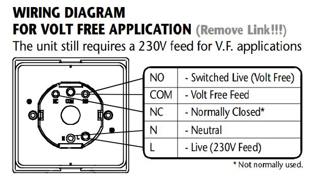

First remove the red link from the HRFS1

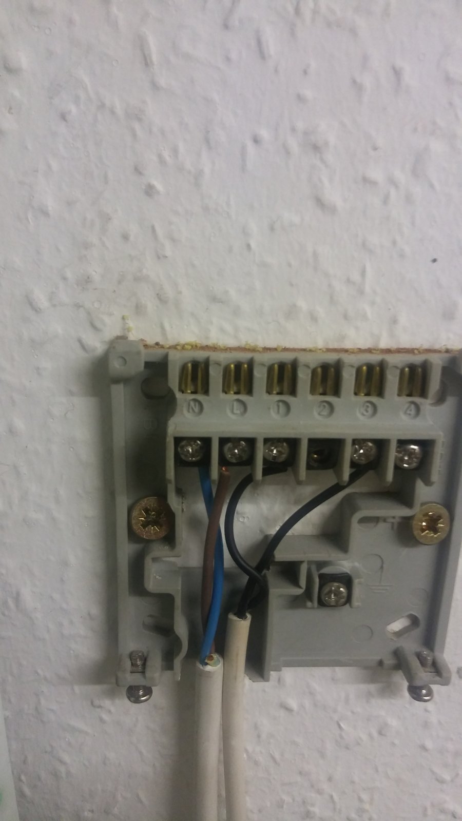

The Neutral and Live from the LP111 go to the N and L at the bottom of the HRFS1 respectively
The wire in terminal 1 (grey?) of the LP111 goes to 'com' top centre
The wire in terminal 3 (black) of the LP111 goes to 'NO'
