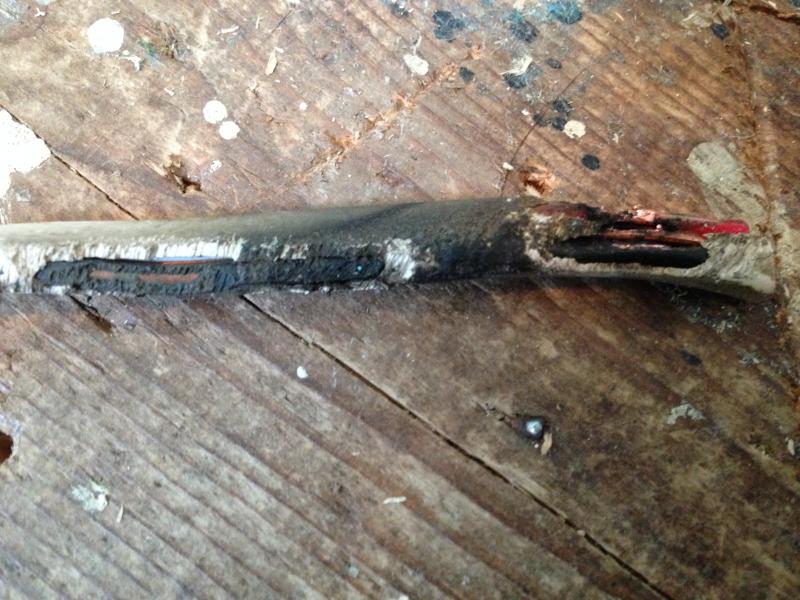

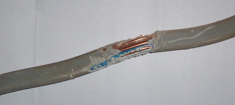

OK, So I couldn't wait for the weekend :)
This is what I found under the floor, not sure what happened ?
The wire goes through a joist but was not snagged in any way and the hole through which the wire passes is a lot larger than the wire itself ?
Thanks again for the input..... Ted
Looks like its been 'nibbled' at to me?
