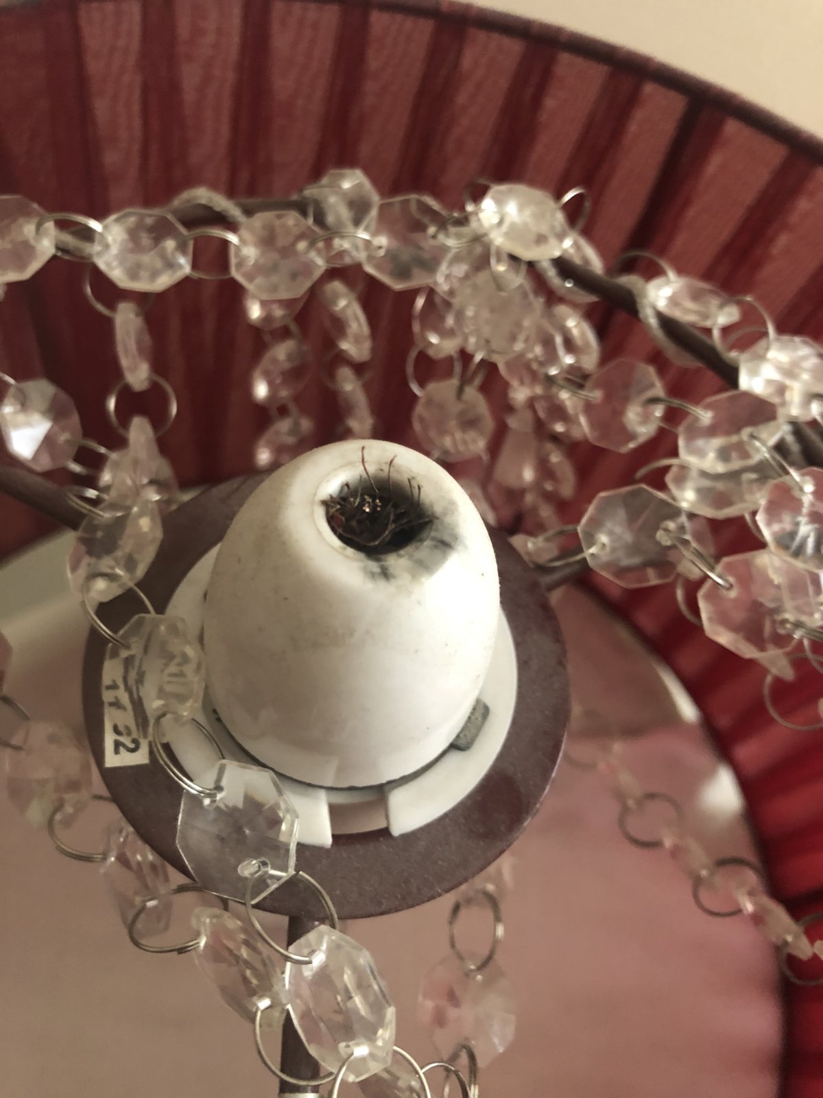

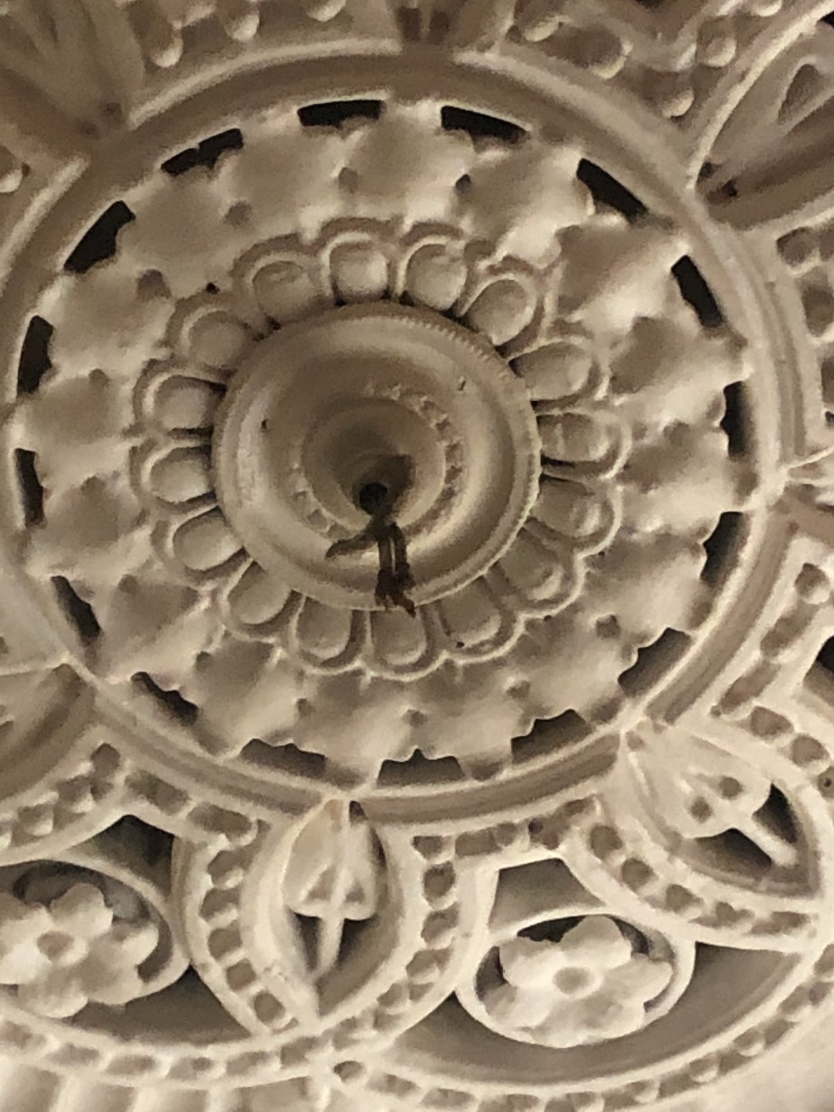

Sorry guys, silly me couldn’t figure out how to upload a photo!
Please see attached.
It’s actually come away lower down than I first realised...thoughts??

I can't see the lamp/shade/chandelier/whatever it is, so can't guess the weight, but I expect that there was nothing to take the weight except the terminal screws holding the wire cores, which have eventually given way.
I can't make out the ceiling rose (if any) or the colours of the wires, but I have seen similar in an Edwardian house that was wired in 1922.

Now those photos are "interesting".
The ornate (non electrical) "ceiling rose" is at least "Edwardian", if not "Victorian".
I note the vents into the roof space - to allow the escape of combustion products from the gas lamp which (no doubt) was originally fitted.
Perhaps there are still gas pipes in the ceiling (hopefully, disconnected.)
(The first house we bought, in Sydney, which was built before 1914, did still have (disconnected) gas pipes for lighting in the roof space !)
It may be that those wires, which appear to be cotton covered VIR, are actually fed via the old gas pipe ?!?!
It is certainly necessary to rewire this light fitting (and, probably, all other light fittings in these premises) with more modern wiring.
If you reinstall this fitting (or any similar fitting), might I suggest that you use a Lewden Plug-In Ceiling Rose such as is shown in https://www.amazon.co.uk/Lewden-Plug-In-Ceiling-Rose-Brass/dp/B00NGT5PJS and https://www.tlc-direct.co.uk/Products/LDMC11A.html
(While there are other brands of Plug-In ceiling roses, in my opinion, the Lewden Maestro is the best available.)
Such a Plug-In electrical ceiling rose (which will support up to 5 kg - on a hook/chain) makes taking down a "chandelier" for cleaning quite easy.
