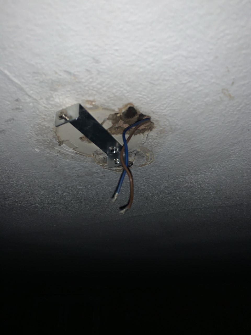

So i decided to replace the light fitting in my bedroom as the one that was currently in place is plastic and old and i wanted something more modern and stylish.

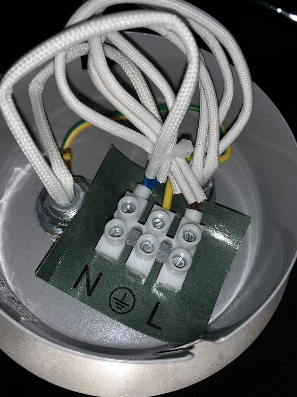

Image 1, is the new fitting i got. 3 wires, Live, Neautral and Earth. Simple.
The problem is there is no earth wire dropping from the ceiling to connect it to the fitting..
The only wires i see is Live & Neautral..
However!
this is where it gets even more confusing for me.

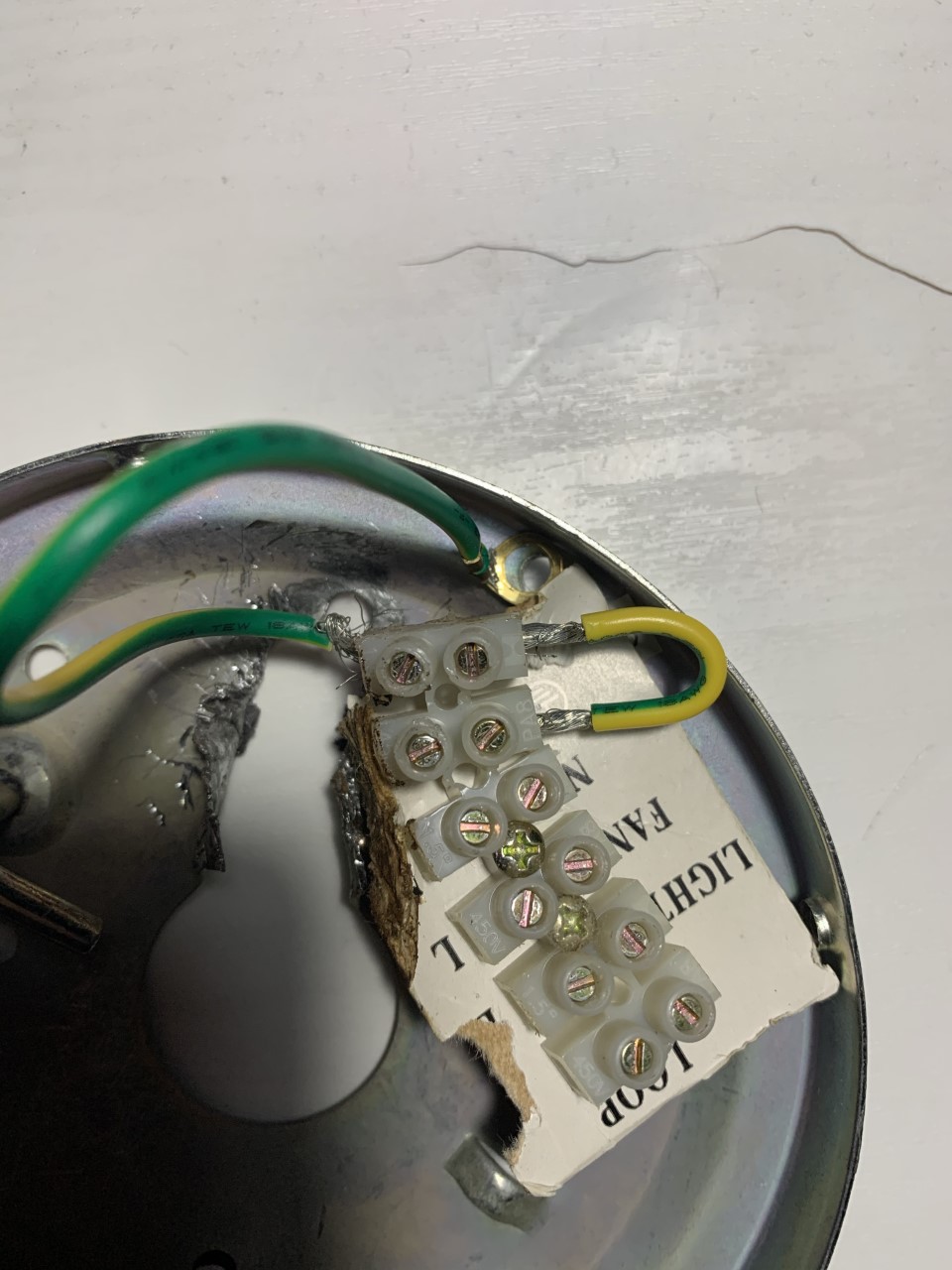

When i took off the PREVIOUS fitting, there was earth wire connected to a screw, not on a metal plate but literally screwed on the ceiling
Image 2 shows the PREVIOUS FITTING (ignore the mess, screws where stuck and bend so i had to cut it/force it out..)

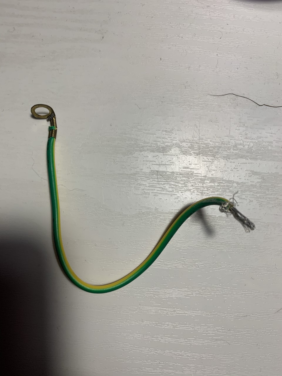

On image 2 you can see the earth wire connecting to the fitting, there was a screw there that screwd in the ceiling (small screw)
Image 4 is the ceileing with the 2 wires (the metal plate thing is just apart of the new fitting)
So what can i do? as there is no earth wire dropping from the ceiling what now? :/
im so lost at this point....
is it possible i can connect the earth wire to the metal thing i installed which is part of the fitting??
since essentially the previous fitting whenever they did it was basically that? (rental house)

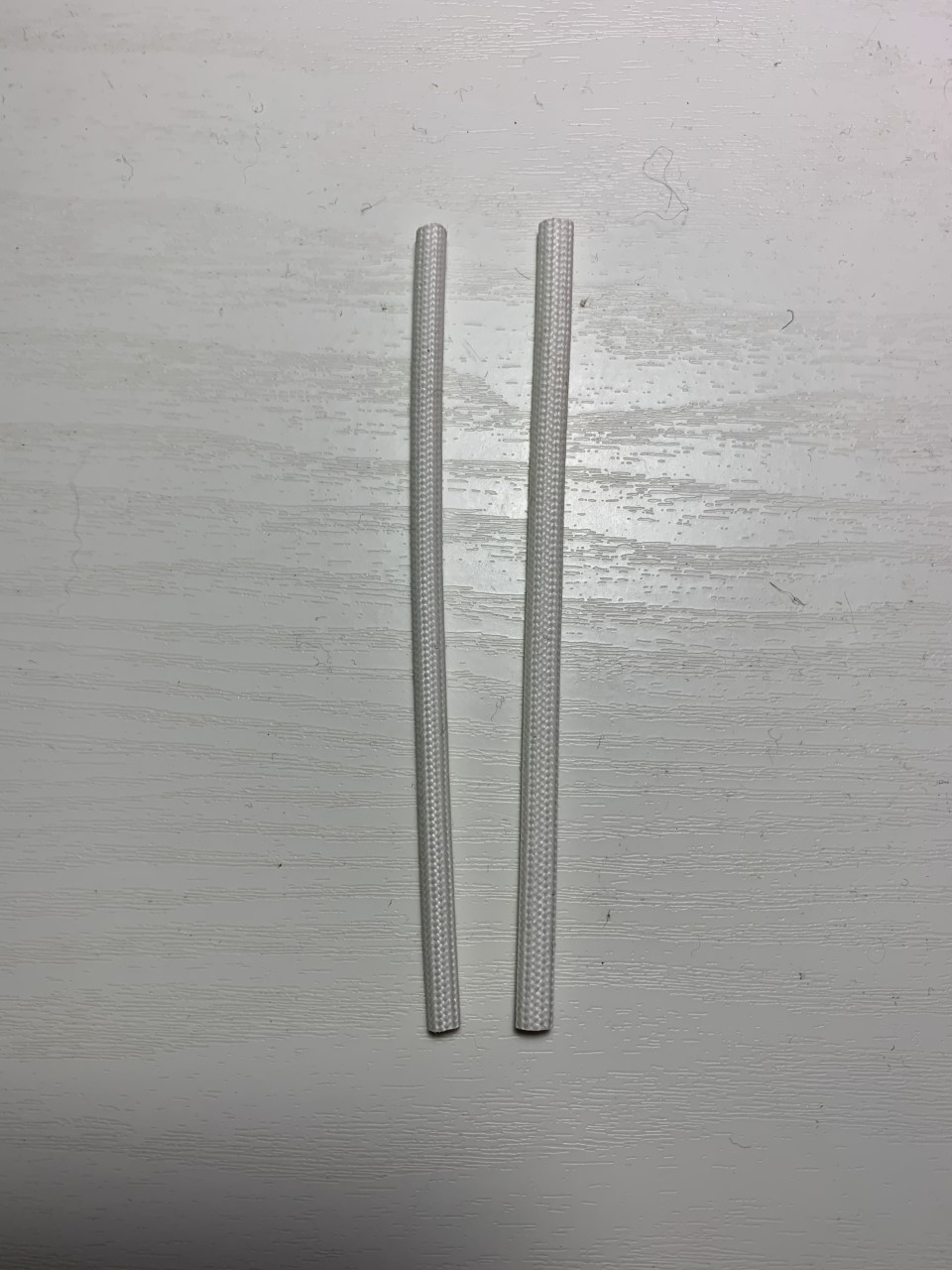

The new fitting also came with these, im guessing its for extra safety for the wires.
Also the fitting is metal which is why i need to connect the earth wire.
The sleeving is heat resistant. What do the instructions say you should do with it?
As for the Earth wire attached to the ceiling it could have been screwed into a metal conduit box but that is unlikely.
You definitely need an earth wire to connect to your new fitting.
Either there is a conduit box in the ceiling or else hopefully there is a junction box or connectors where the blue and brown wires attach to the lighting cables.
You will need to investigate further in the ceiling void, which means you may well need to lift the boards above.
