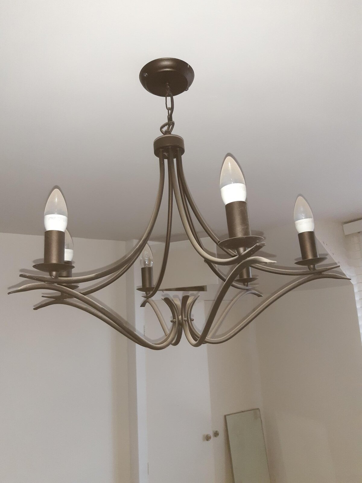

I have a light fitting (photo below) which is making a very low volume "buzzing" sound even when the lights are off. This changes slightly in pitch and volume when the lights are turned on. Really not sure what is going on as there are no electronics involved so I think it must be some form of resonance. Any ideas on how I can stop it?

Why do you have one (apparently) non-functioning Incandescent lamp in this fixture, together with four other (unsuitable and unattractive) LED "candles"?
Lamps such as these "Filament" LED Candles (with appropriate "bases") are much more attractive, long lasting and efficient.

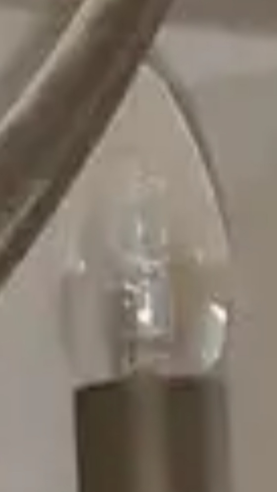

It looks to me as if it's a halogen candle.bulb - which leads me to the question - does the OP have a dimmer switch for this light fitting?

Firstly, don't get too upset by the mix of different lamp types - this is a house I am completely gutting and extending so any lamp mix-match is temporary.
The photo was taken with the light off so the halogen candle is a worker (the others are candle LEDs). There is no dimmer or smart switch.
Anyway, this morning I decided to experiment and it doesn't matter if it is a halogen or LED lamp fitted but if there was at least one lamp present (tried one lamp in several fittings and got the same result) then the noise persisted - remove all lamps and no noise - not really unexpected.
Now the strange part - I refitted all lamps in a completely random order and now no noise!

So, had a little play today and found that with one particular fitting (chosen at random), if I removed the lamp then the sound started (in that fitting - buzzing sound). Replace the lamp (I tried two and it made no difference which one I used) and the sound stopped. Not sure if I would have achieved the same if result if I had chosen another fitting. It's not very consistent!
