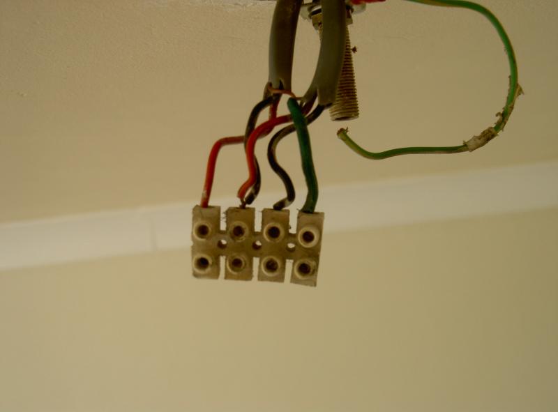

Hello again,
I have now had a closer look at the light fitting wiring, which is actually working,
but I'm a bit confused. The switch contains two wires, a red and a black, with the black going to L1. I'm happy about that, although I thought the black wire should have a bit of red tape on it....has that gone out of fashion now?
Then there are 2 cables coming into the light fitting, which I guess is 1 from the switch and one from the circuit, assuming this is the last light fitting on the circuit.
The earths are all together, but then things start to go a bit loopy....the light fitting brown (live) flex seems to be teamed up with a red wire. I would have expected a (switched) black cable to go to the live flex???
And there is one black cable going in with the blue (neutral) flex, with the red wire from that cable joining up with the black wire from the other cable.
Does that make sense?
I thought the neutrals should be in one terminal, the earths in another, the lives in another, and the switched live going to a terminal with the live flex for the light.
So why have I got a red cable joined in a terminal with my brown flex from the light?
Cheers
Trev

The black should have a red sleeve.
I'm lost!! I can see 2 reds and 2 blacks in the pic, the black to the switch should also have a red sleeve. Is it that they have used black as permanent live and red as switch live?
Can you take a clearer photo showing the two cables and all the wires?
If another light was switched with this one this may be the case, however I can only see the 2 pairs of wires at the bottom :confused:
I've undone the light connections (well, the earth just broke actually), but the brown flex from the light was going into the leftmost terminal with the red wire, and the neutral from the light was attached to the same terminal as the black wire 3rd from the left, next to the green :)
Hope that makes it clearer.

You would ideally have a red sleeve on the black wire from the switch. The 2 reds would join together but to nothing else (use the loop terminal). The black with the red sleeve to the L and the other black to the N.
Both earths together and to the earth terminal.
As it stands, they are either switching the neutral or using the black switch wire is the permanent live. Do you have a multimeter?
Turn off the power, split all 4 wires out and using ohms range test across red - black on each cable whilst someone operates the switch.

The cable on which you see the resistance go from high to low etc when the switch is operated is the switch wire, you need to sleeve the black wire red on this cable. This will go towards ensuring you wire it up correctly when you reconnect it.

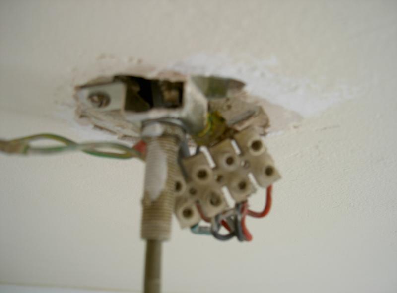

Just looking, I can't see a loop on the fitting you posted a pic on the other thread. You may need to use a piece of terminal block to join the 2 reds in this case.
Black with red sleeve to L
Black without sleeve to N
Both earths to the earth terminal.

Because they are the permanent lives - the red is in the lighting loop, the black goes to the switch.
The left hand cable is the one going to the switch. In your case, the black is connected to the live from the other cable & the red is the switched return from the switch.
The right hand cable is live, neutral & cpc from the last light.

From his description it was wired like this:
So yes - the cable on the left could be the circuit one, with either reversed polarity, or the neutral switched, but it all seems unlikely.
Anyway - surely the easiest thing to do rather than f*rt around trying to do continuity tests on the switch to find the switch cable would be to measure the voltages at the choc-block to identify the circuit one?
