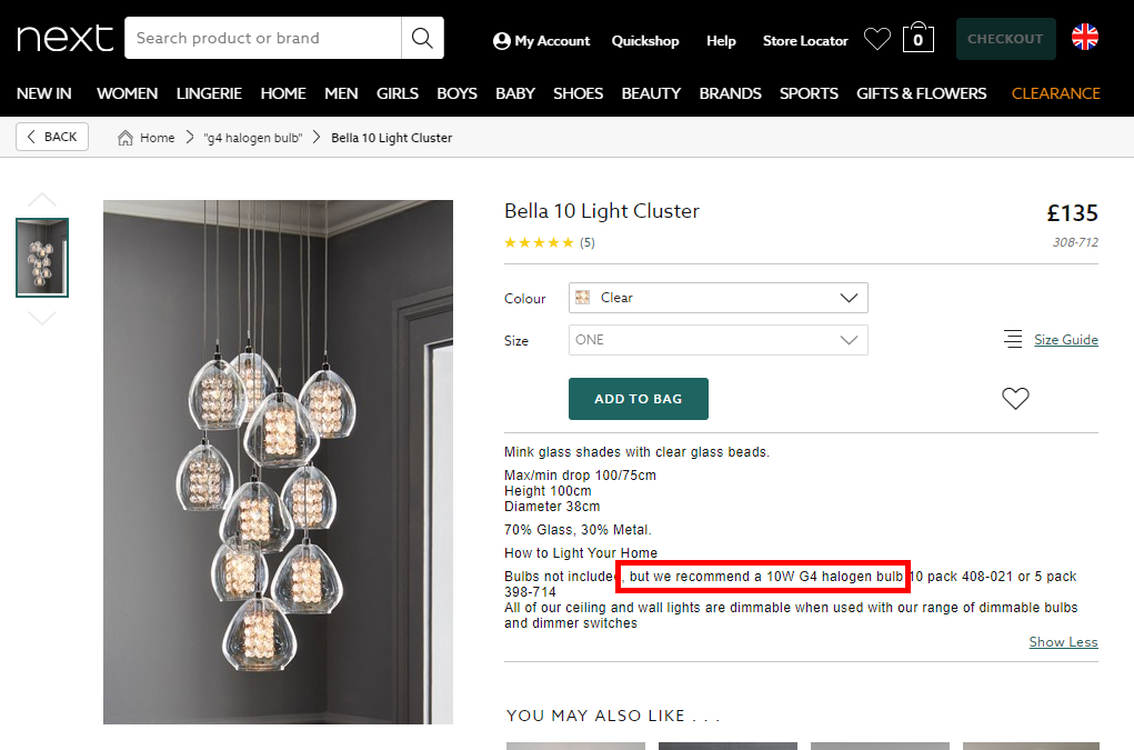

Hi Guys, I have recently changed a Light Fitting(like for like) called Bella 10light Cluster from Next. The bulbs used are 250 lumens 20W G4 Halogen, recommended and purchased from Next.
The 1st fitting worked well for over a year but all of a sudden just stopped but you can see the bulbs where on as there is a very very small dot of light in the bulbs. Once changed for a new like for like fitting, when 8 out the 10 bulbs are in it works but when you put the 9th bulb in the light in it then just goes back to to the very small dot of light( which can only be seen if very close to the bulb). It’s as if I have a dimmer switch and the just goes down to nothing!

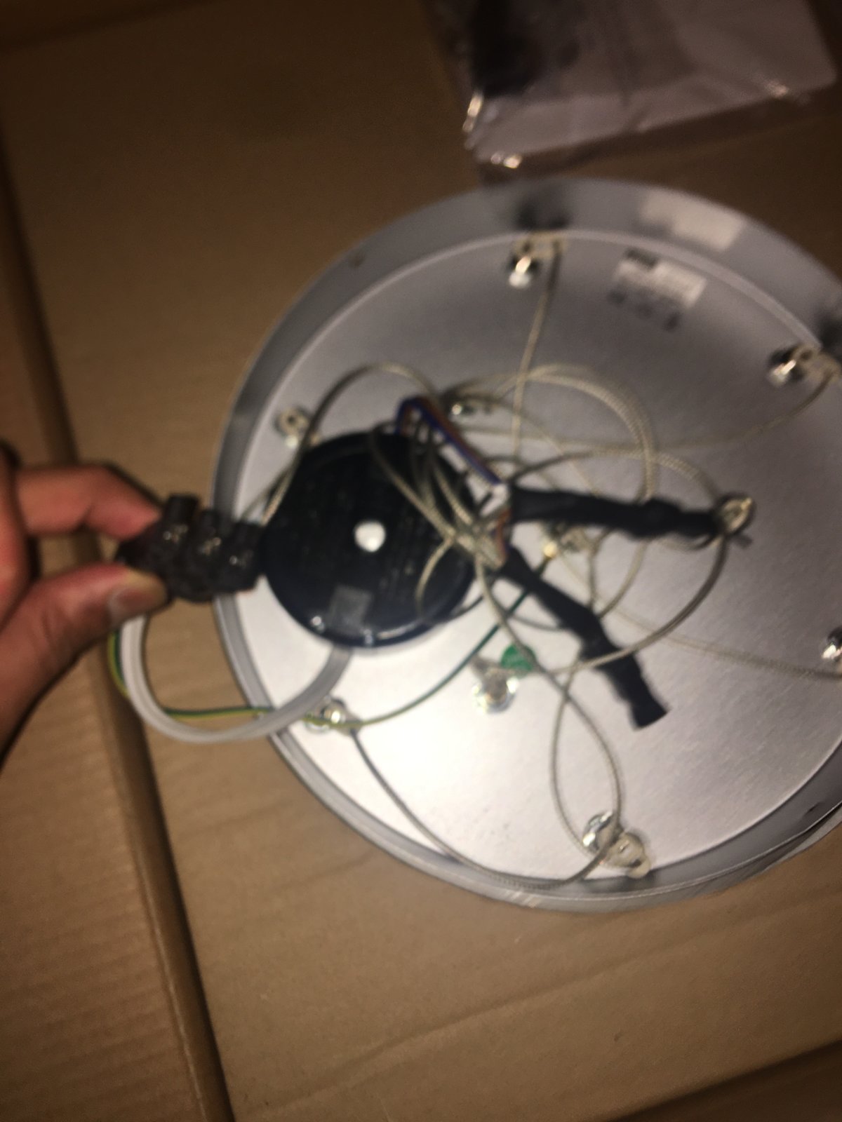

Is the power supply (I doubt if it is a transformer) part of the fitting or a separate component that you have re used for the new fitting?
I sorry but I’m an amateur with this stuff!
the whole fitting is brand new and is connected to the 3wires from the ceiling... 1 blue, 1 brown and 1 yellow and green striped wire.
They was just connected to the fitting in the light.
As above, its likely the 20w lamps are to big and the transformers shutting down, it likely needs 10w lamps
Somewhere on the fitting will be a label stating size, or do a better pic of the transformer thats in the base you show above
Flipping hell...when purchasing online And going to checkout Next then give you the option to purchase the recommended bulbs.
School boy error....I should have read it properly
