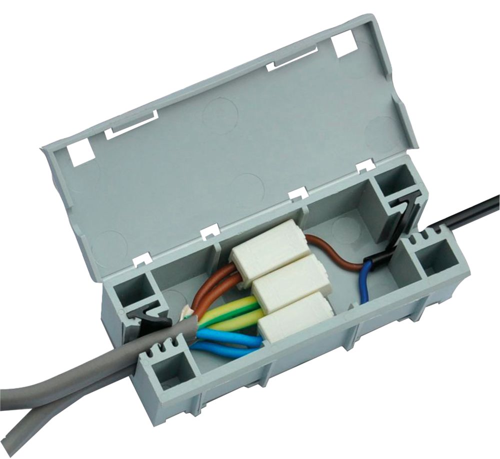

I currently have two 2-bulb spot light strips in my kitchen, which I'd quite like to replace with one fitting. How do I securely, and safely, deal with the wires from the "spare" fitting? Or should I just leave it all as it is?! :)
Many thanks in advance
If you are looking at something like this
then likely there is only one feed. If there are two feeds you can get lighting junction boxes
which are designed to take the extra wires used with lights and also has cable grips, as to if one shown or a maintenance free type
ae235
as shown here depends on the access once the job is done.
