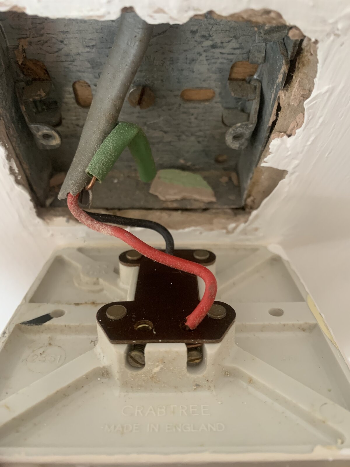

Hi all.
I am replacing this switch, on removing the old one I came across this. I am assuming this green wire is the Earth and should be connected to the spare connection point in the switch?
nooooooooooooooooooooooooooooooooooooooooo
the green should be connected to the metal backbox
no
thats just a live connection being connected to together - Red to Black (NOT Neutral) when switched - so the live is then connected to the light
So be careful, based on the question , you do not understand electrics - - beaware that electrics can kill
Either the red or black is the live from the ceiling rose. By convention the red would be the live, but that is not always the case. The other (black or red) is the "switched live" and it runs to the light fitting.
In the light fitting there will be a neutral wire(s) to complete the circuit.
As others have said, the earth should be connected to the metal back box. Without the earth connected to the back box- in the event of the live hitting the back box, the screws on the switch will become live.
If you are fitting a metal light switch, you will need to earth the switch, rather than simply earthing the back box. The earthing point will be on the reverse of the face plate. as per @Taylortwocities
Post a photo of the reverse of the new switch before fitting it and one of the electricians will be able to help you. It should be pretty straight forward.
